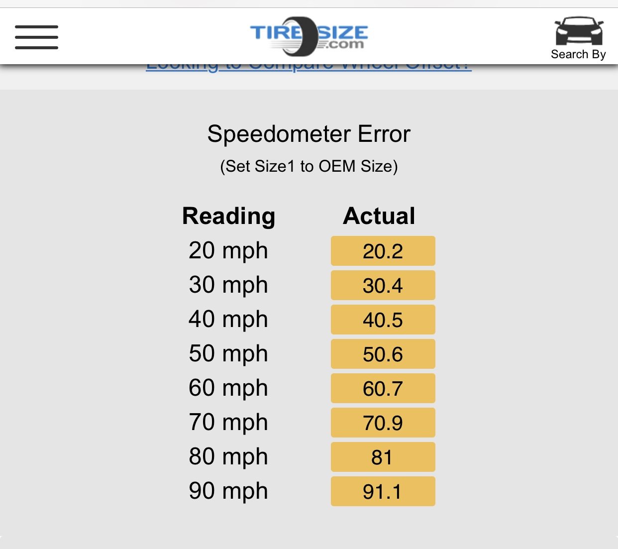

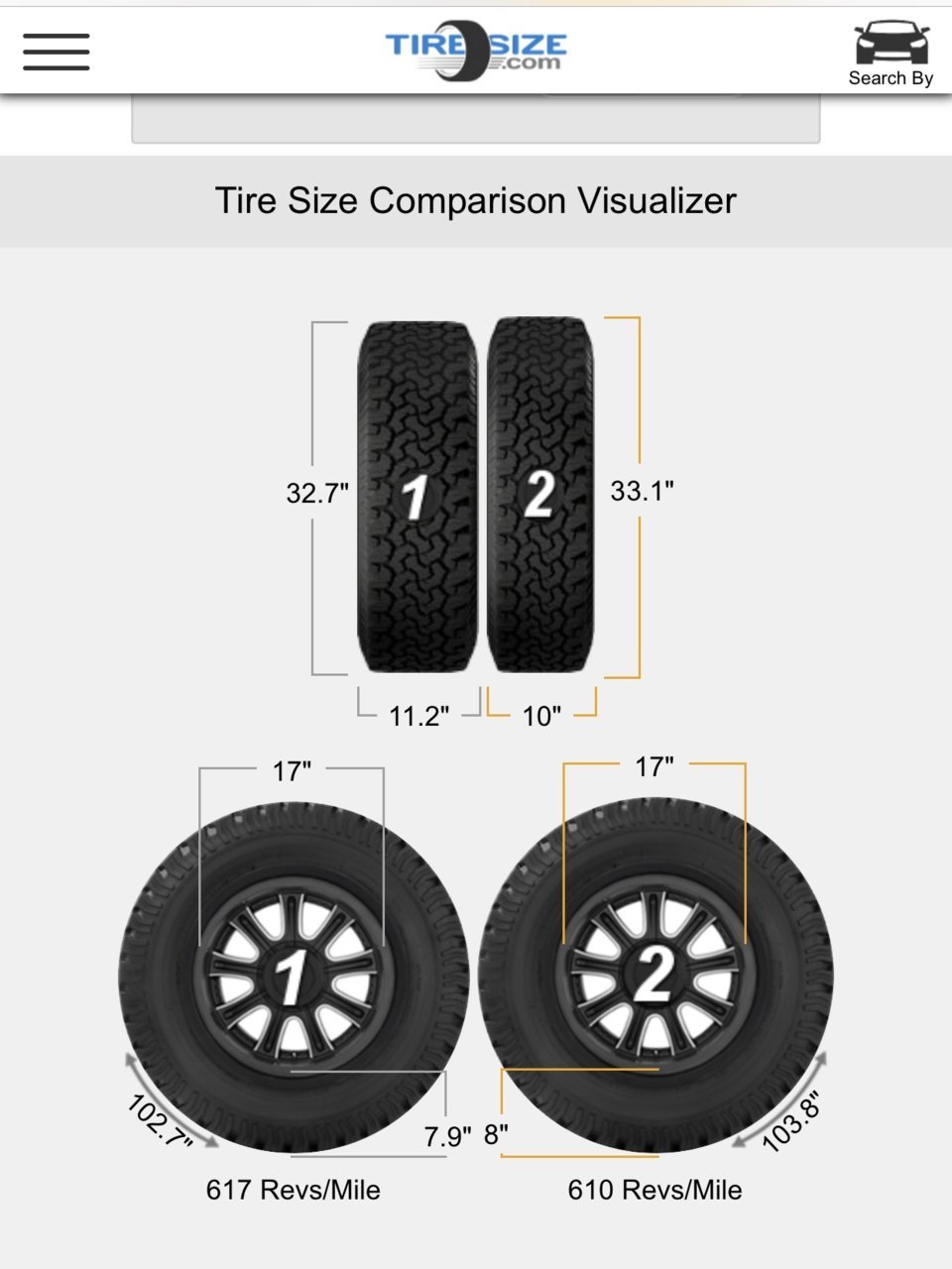

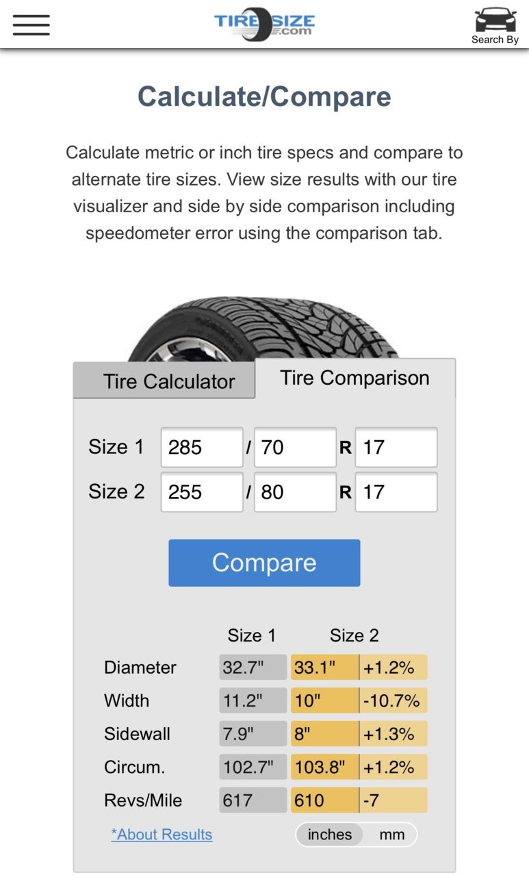

    1) Where do you find best price for 285/70/17 and 255/80/17 tires...
    2) Will the 255/80 at 33.1” sit noticeably higher than 285/70 ar 32.7” per Tire calculator comparison.
    2) What are your thoughts on ST Maxx Vs Duratacs or any other brand/models that you recommend. 508D7C6D-B43B-4364-8D78-0D849DB6CA4F.jpg

    Gotta look on the tires website for full spec of the tire. St max is 32.8" and the duratracs are 33".
    Both tires are proven offroad worthy, so buy what is cost effective, tread design you like, weight etc. your gonna be happy either way.
