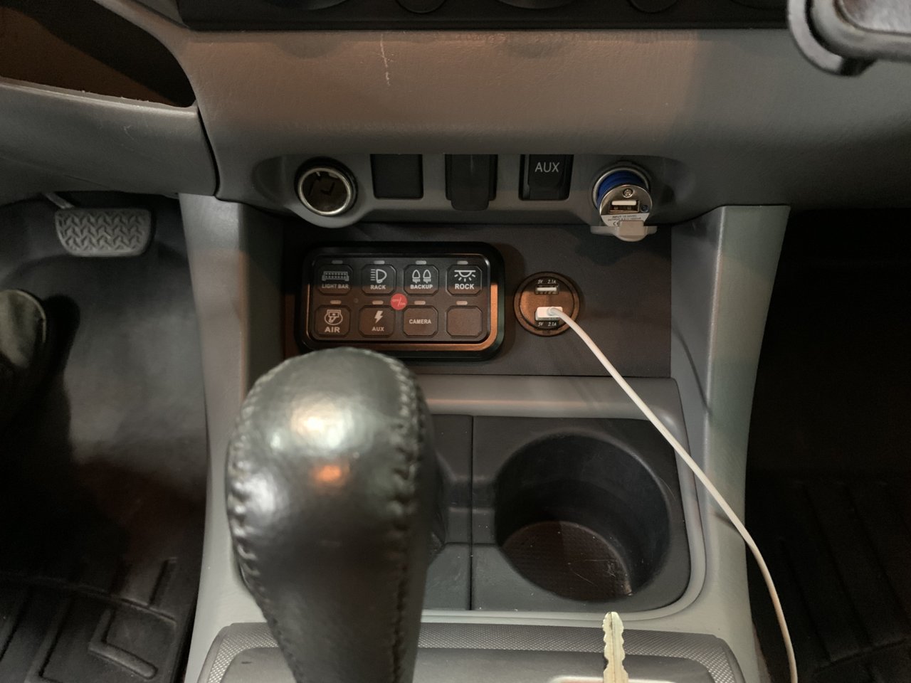

    Circuit controller is by Auxbeam. Wanted Spod, wallet said no. Panel is a DIY and I plan on adding a 110v outlet on the right eventually.

    Details on how you made the panel?

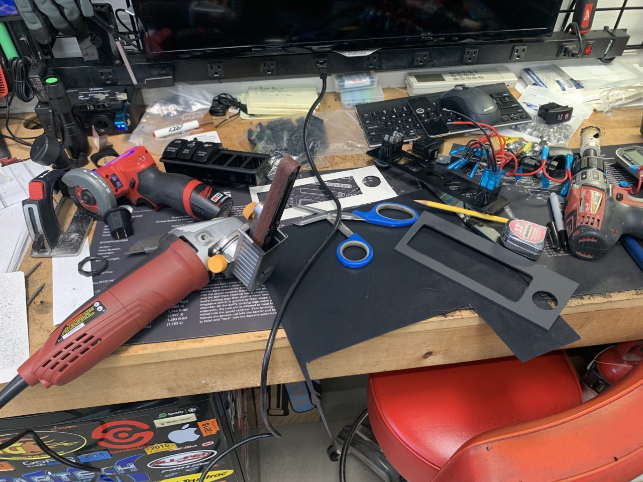

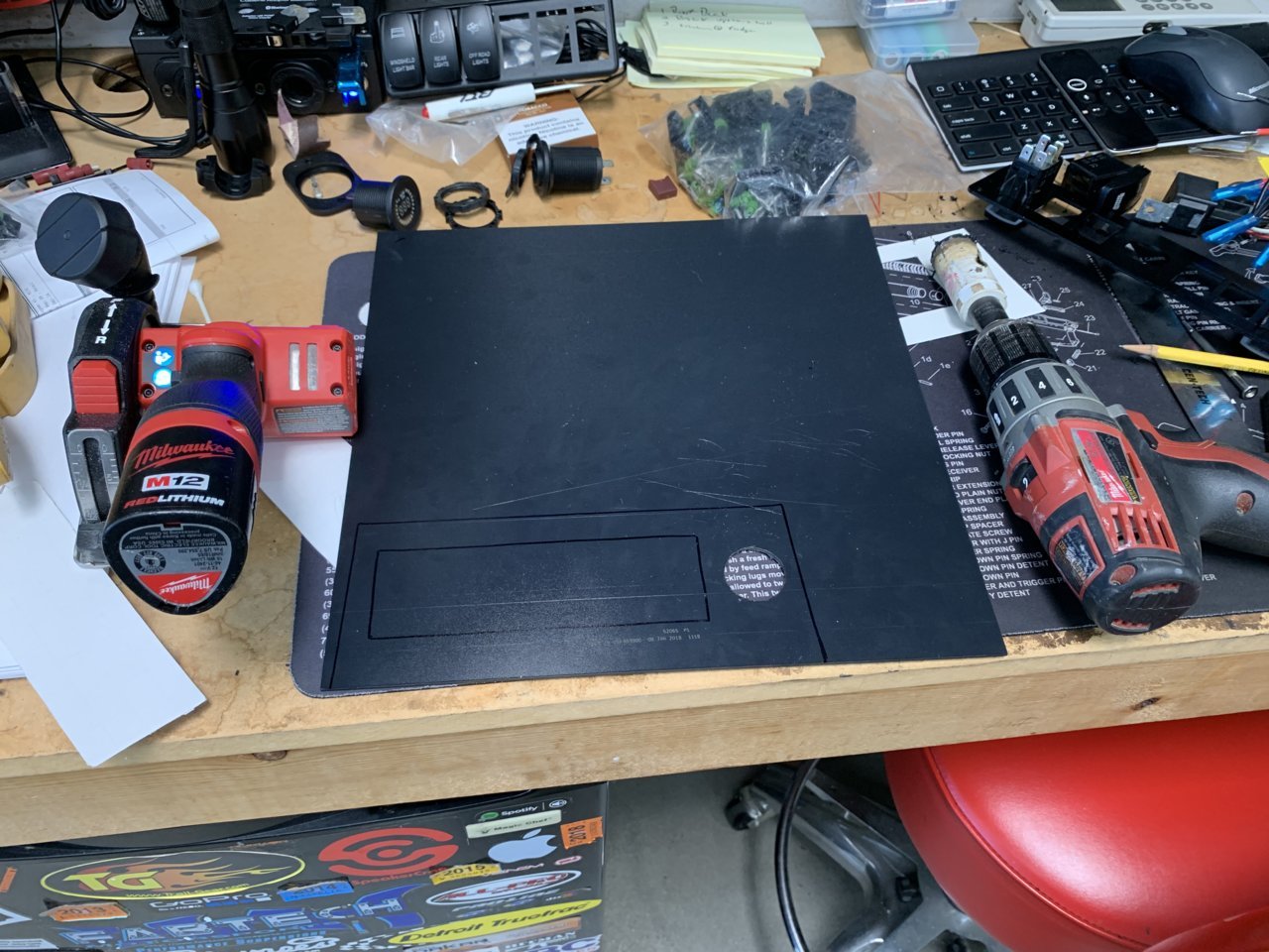

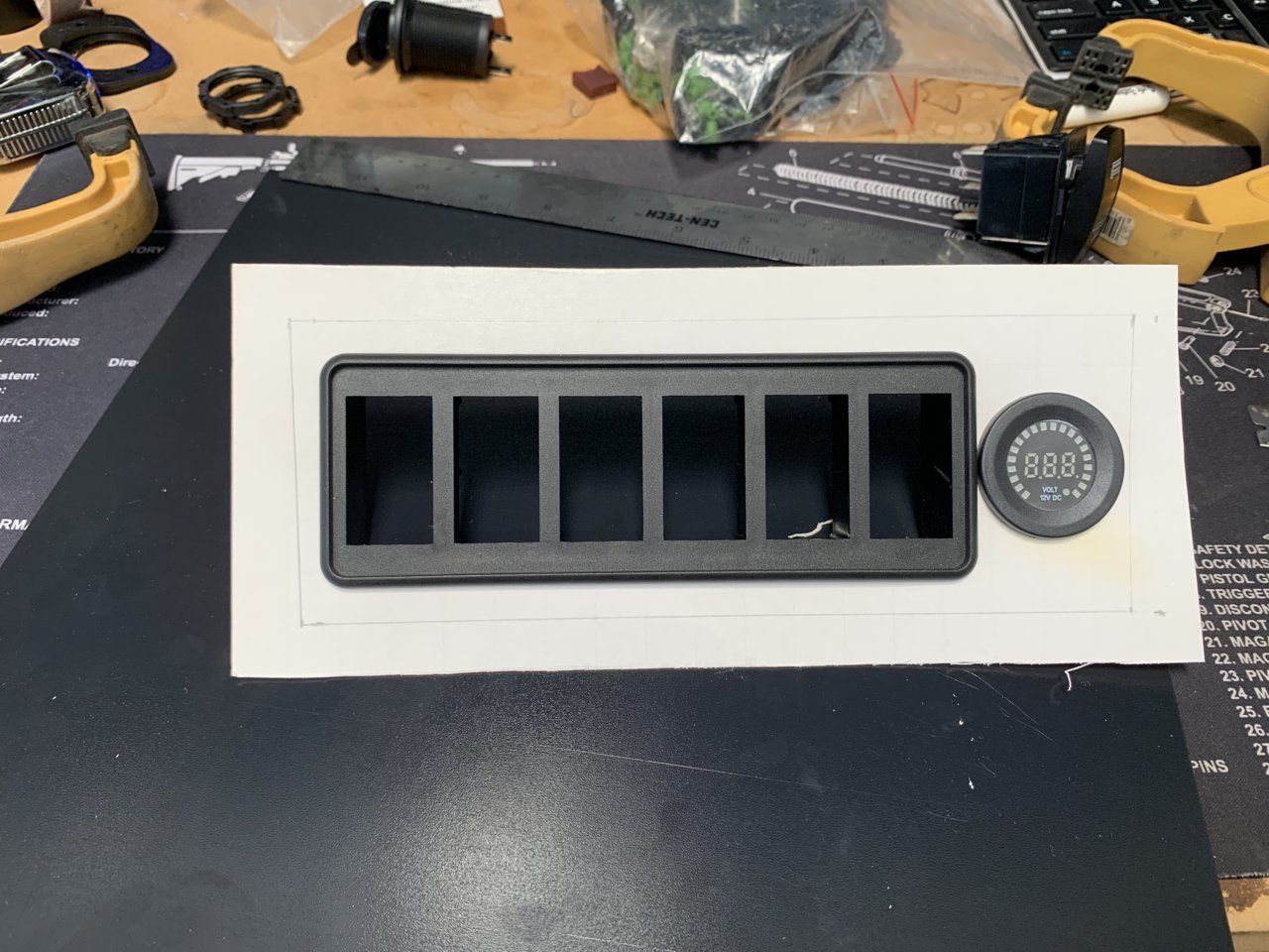

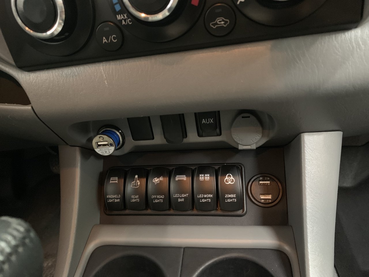

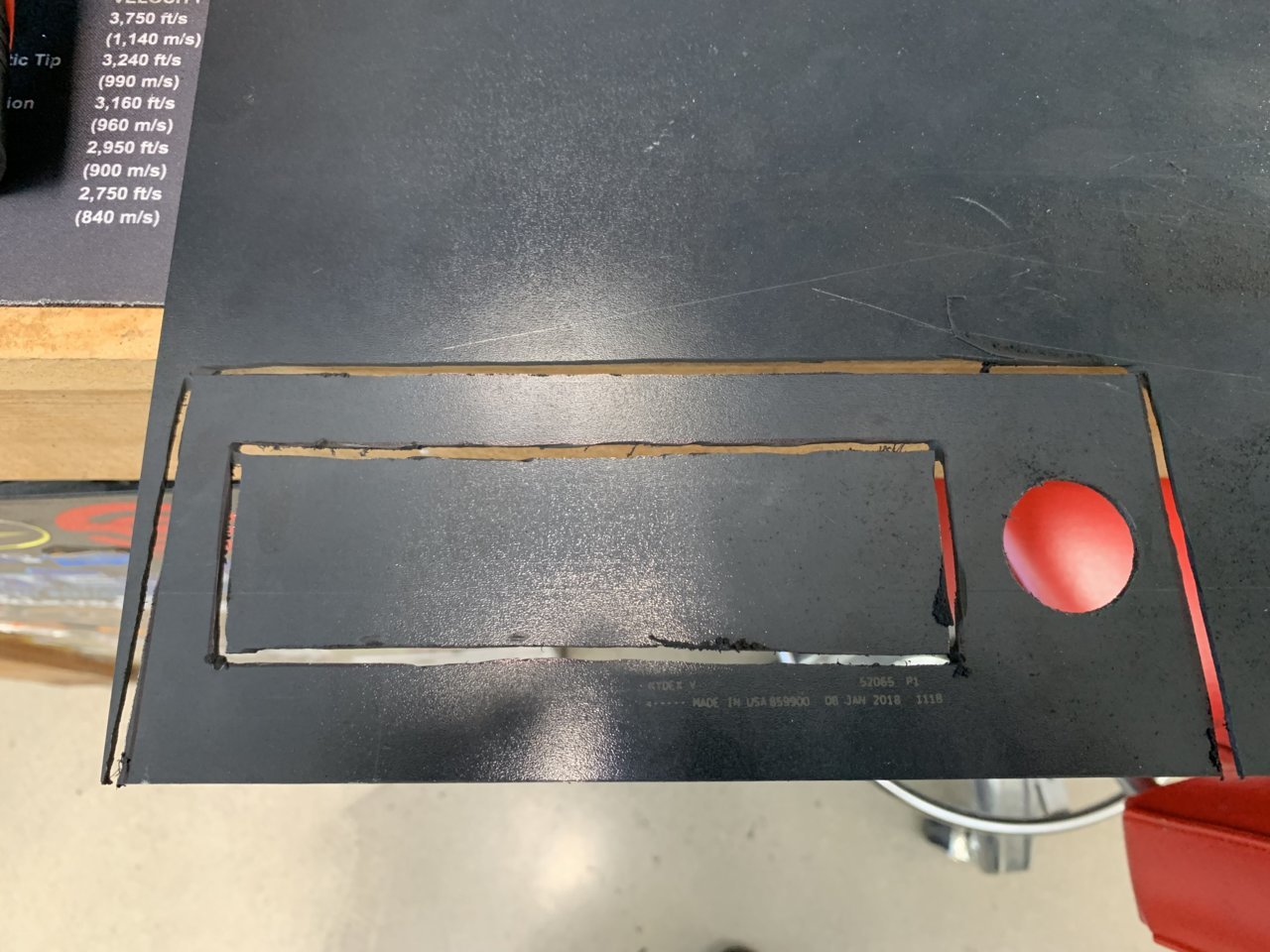

    Cardstock template, transferred to Kydex sheet. Trick was a lot of trimming to get the cardstock to fit just right.
    Cut and fitted it, made a tiny half circle cutout in the back of the pocket and the bottom of the dash to pass wires through. Console can still be removed without having to pull wires out.
    Mounted with Black RTV, it is a semi press fit anyway, cannot go further in due to how the pocket lays out.
    I don't have any pics of making the one for the Auxbeam controller but here was my first go around when I was going to use conventional switches. IMG_2325.jpgIMG_2331.jpgIMG_2333.jpgIMG_2335.jpgIMG_2339.jpgIMG_2349.jpg

    what keeps the sheet in place?
  15. Dec 23, 2019 at 2:53 PM
    #35
    Richie Rich
    Richie Rich Toyota Hoarder
    May 3, 2014
    #129031
    581
    760 (San Diego)
    2010 X-Runner 2011 TRD Sport DC 4x4
    More than I can afford
    It is a press fit and a tiny bit of black RTV.
    Have gone wheeling a couple times since I put it in, hasn't moved. I try really hard not to drill extra holes in my truck (odd because I have a snorkel and high clearance rear bumper but whatever).
    I used the same material and methods to put a USB and 12V socket in the storage cubby next to the 110 outlet in the bed.
    If I had to do it over I would have used a thicker sheet of Kydex tho, it deflects a little when you press on it. Used what I had on hand (leftovers from another project).
