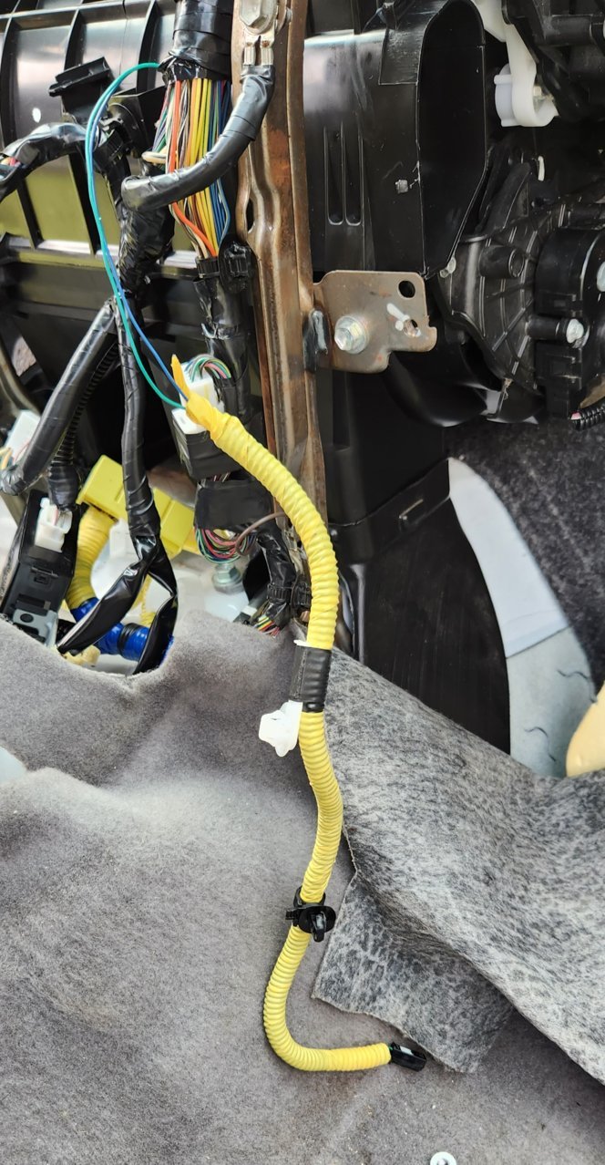

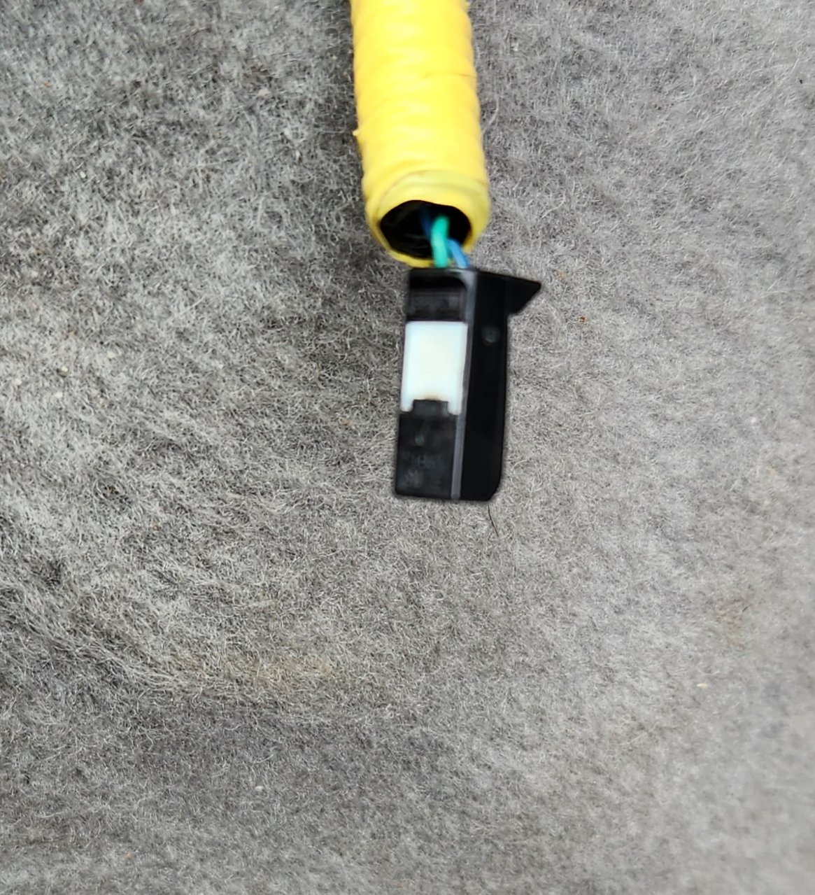

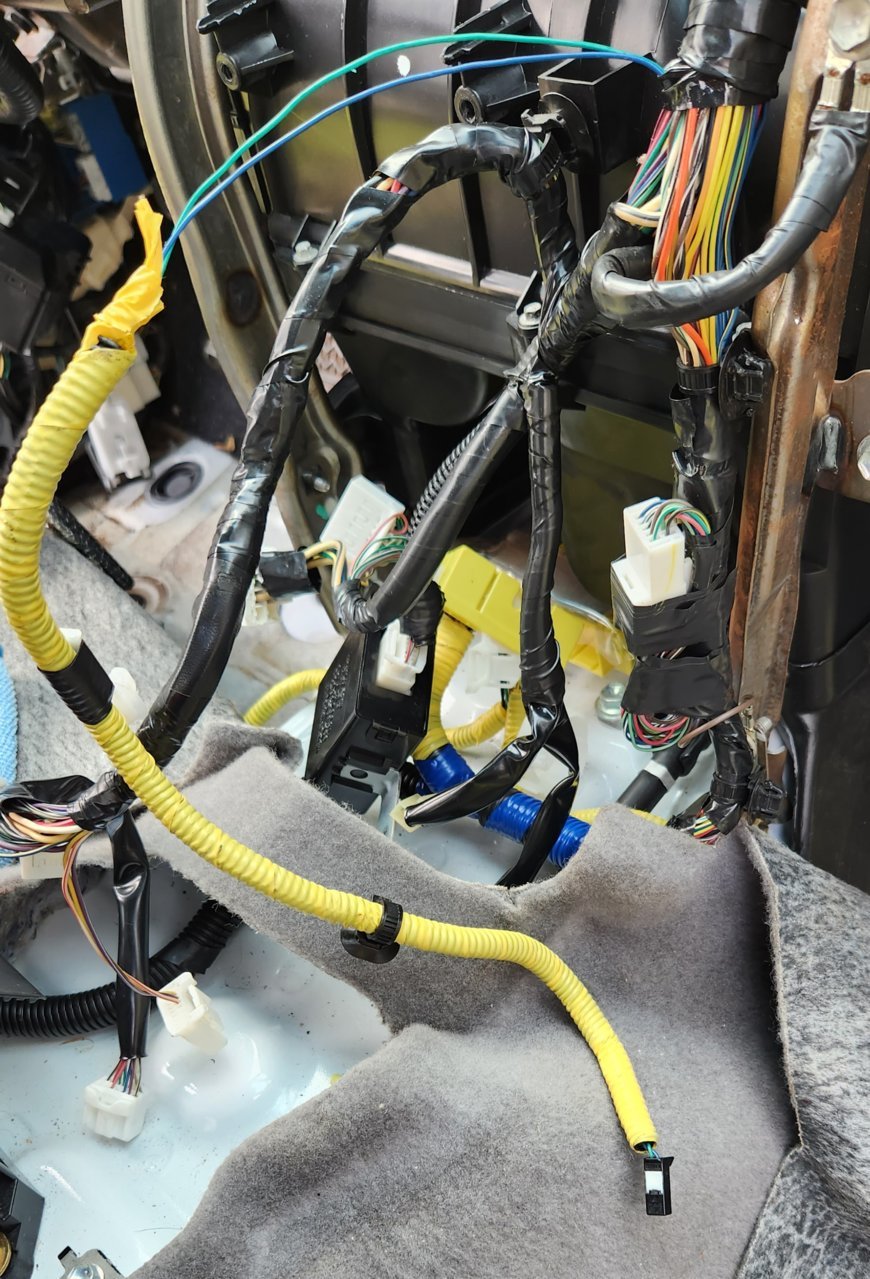

    20221206_135056.jpg 20221206_135056.jpg 20221206_135056.jpg 20221206_135138.jpg 20221206_135124.jpg Pulled the harness on my 2006 Tacoma Pre Runner and cant seem to figure out where this tiny 2 wire plug goes. Any ideas?

    Got a picture?

    Yellow is typically Airbag related.
    Is your truck an access cab?

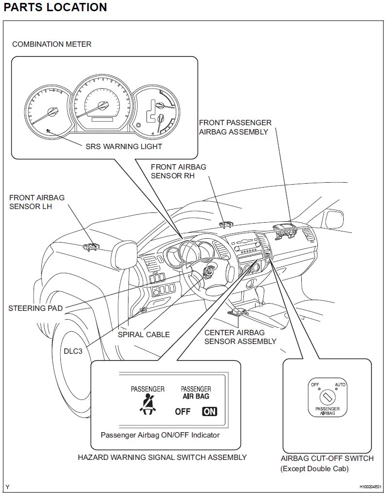

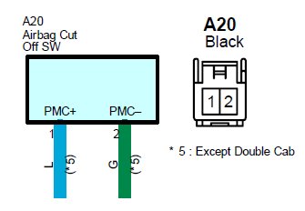

    It looks like the Airbag on/off switch connector.

    Looks like it, wire colors and connector match.

    Thanks for the wisdom. I have a four door. Do the four doors have an on/off switch for the passenger side? Now im thinking that the plug was never connected in the first place.

    Mine doesn't but it's a 14, not sure about previous years.

    thankyou. i left it disconnected.
