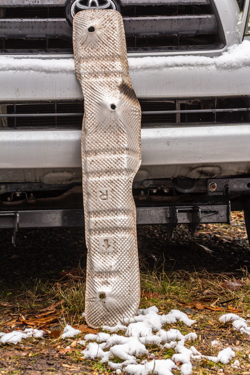

    This heat shield fell onto the ground while driving. Can someone tell me where it belongs ?

    Looks like the exhaust shield ahead of the muffler. Right side of truck and bolts to the body underside. I believe the top of it , in your photo, faces forward.

    Right side, between CAT and body. Arrow points forward. Take off nuts and reattach using fender washers.

    I reattached the front of mine with a large fender washer.

    had one rattle like hell, these def help

    Mine definitely fell off from rust the other day! Took some JB weld and some washers. Fixed her right up
