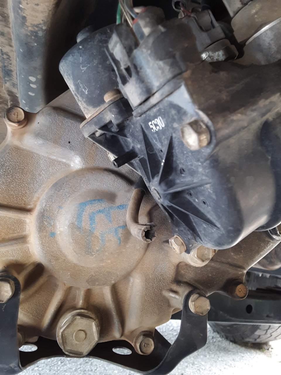

    Does the little rubber hose hanging down plug into the connection above it? That rubber piece is really rotten just want to make sure before I plug it in there. Thanks

    I suspect it does. You should trace the hose to the other end, then replace it.
    This end is split and torn, it won't stay on.
    I suspect you are having trouble shifting into 4WD

    Vent tube At least that’s what I was told I have the same exact thing on my 2005 I have no issue shifting into four-wheel-drive

    As for OP it's the ven breather for the actuator the black plastic thing there it goes on the nipple protruding from it, you can hit the nipple with a some coarse sand paper to rough it up then use a tiny zip tie to better secure it.
