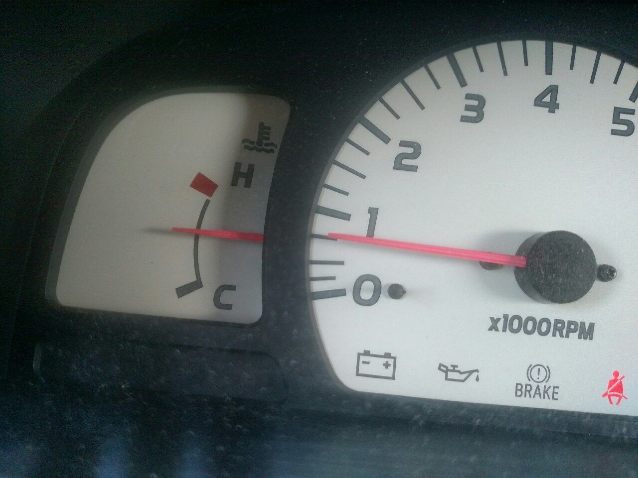

    The temp gauge on my 2.4 gradually comes up to halfway as as the engine warms up.
    Once there at half, it's stable.
    Breadcrumbfail, if you want to test the gauge. Go buy another sending unit and attach the stock lead to it. Attach a good ground to the threads. Place sending unit in a cup of boiling water from the microwave (212 degrees) Even allowing time to get from the microwave to the truck, the gauge should still climb.
    I'll have to try this on my truck and see : )
    At least that should tell you HOT VS NORMAL.
