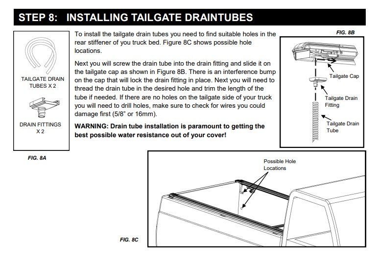

    Installing a Pace Edwards Ultragroove on my 2023 Off-Road. Love the front bulk head grommet install. Absolutely doing that. Ideas for the tailbed drain locations? I'm leery about drilling into the sides.
    Here are the instructions
    As one user said should I wait to see if the water is actually an issue from the rear?
