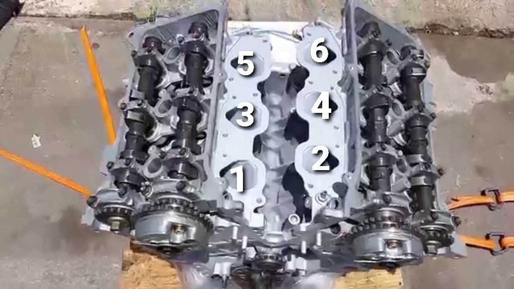

    if im not mistaken the 4.0 v6 cylinders go like this:
    5 - 6
    3 - 4
    1 - 2
    So bank 1 would be passenger side sensor 2 is downstream

    The cylinders order are correct but on the Tacoma's 4.0 along with many toyota engines, Bank 1 is located on the same side as cylinder 1(driver's side). Sensor 1 is pre cat /sensor 2 is after cat.
    OP, you are correct. (B1S2) O2 sensor is located on driver's side after cat. As suggested, stick with Denso.

    Per what you said wouldn't that make bank 1 on the passenger side? Since cylinder 1 is on passenger side? Bank 1 is on the side with the forward most cylinder, correct?

    You are right. Brain fart. Sorry OP, disregard previous post. Sensor is on passenger side after cat. Thanks Strictlytoyz for the correction. One too many beers right now.:cheers:
