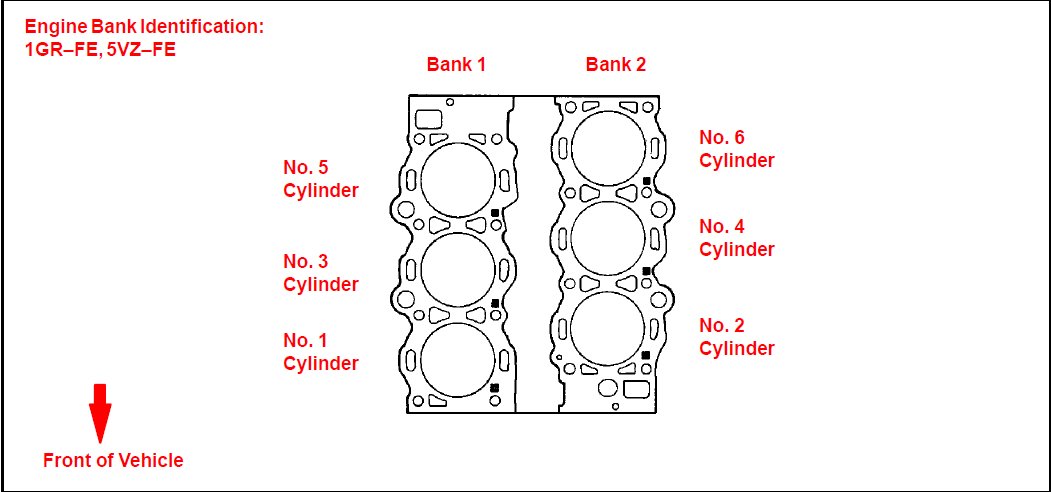

    Bank 1 (B1) refers to the bank that includes cylinder No. 1.
    Bank 2 (B2) refers to the bank opposite bank 1.
    Sensor 1 (S1) refers to the sensor that is located before the catalytic converters.
    Sensor 2 (S2) refers to the sensor that is located after the catalytic converters
