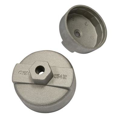

    You could just buy a toyota specific oil filter wrench like this from the parts department and maybe grab a bunch of drain plug gaskets while you're there.
    And all you need to use it is a ratchet with a 24mm socket
