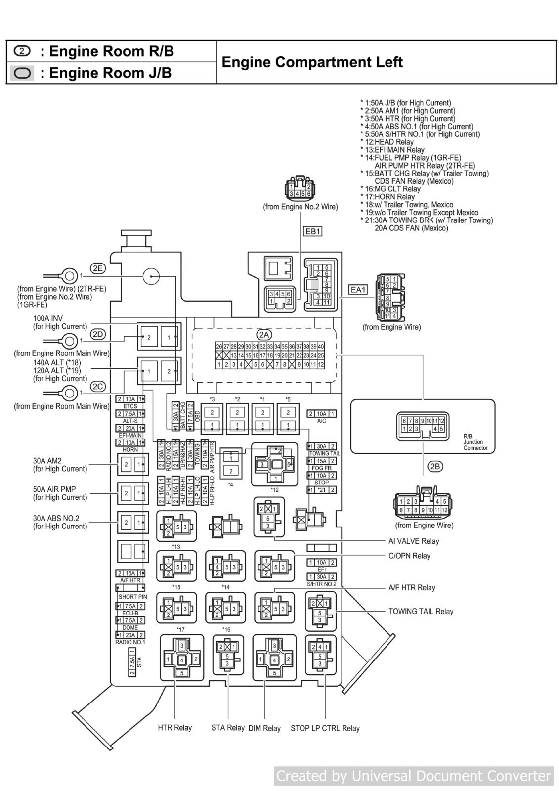

    how can you bench test a 2014 Tacoma a/c amplifier?...i dont want to buy a new one ....and i dont have nobody with a 2014 tacoma to swap my amplifier and test it

    i had a no good mechanic ///to begin...i jumped the contacts on the ac mag clucht relay and the clucht worked...i took my truck to this guy ..i dont know what hed did ..now the clucht is no working and he is blaming the a/c amplifier...i removed the truck and took it home...now i have a clucht thats not working and apparently a bad amplifier....i asked him...if he use a scanner ..he said yes and there is no code...i parked my truck again...did anyone know how to bench test this amplifier and /or a sequential troubleshooting test that i can follow with my voltmeter..i used to be an I/c tech and ill try to solve this problem..

    Ok that tells me it's trying to command the MG CLT Relay on, you say the clutch does not engage at all unless you jump pins 3 and 5 of the MG CLT relay though?
    I'm assuming you already tried swapping relays?

    yes i used the horn relay ....before taking my truck to this mechanic i used to jump the relay and the clucht engaged...but i dont know what he did ....now not doing that..i might have to check the ohms of the clucht ..to see if i get 2 to 5ohms....i havent done that yet....to eliminate that part...and then look into the amplifier...i wish i could get an info on how to bench test for voltages...

    Do you have a test light?
    If so we can narrow this down pretty quick, test light connected to battery Ground check for power on Pin 2 & 5 of the MG CLT Relay with the key on.
    Then test light connected to battery Positive check Pin 3, it should light up if the wire is continuous to the clutch coil and the coil windings are good.
    If that all tests good then with the light still connected to battery Positive start the truck and have an assistant hit the A/C button while you hold the light on Pin 1 of the MG CLT Relay, it should light up briefly until the light starts flashing.
