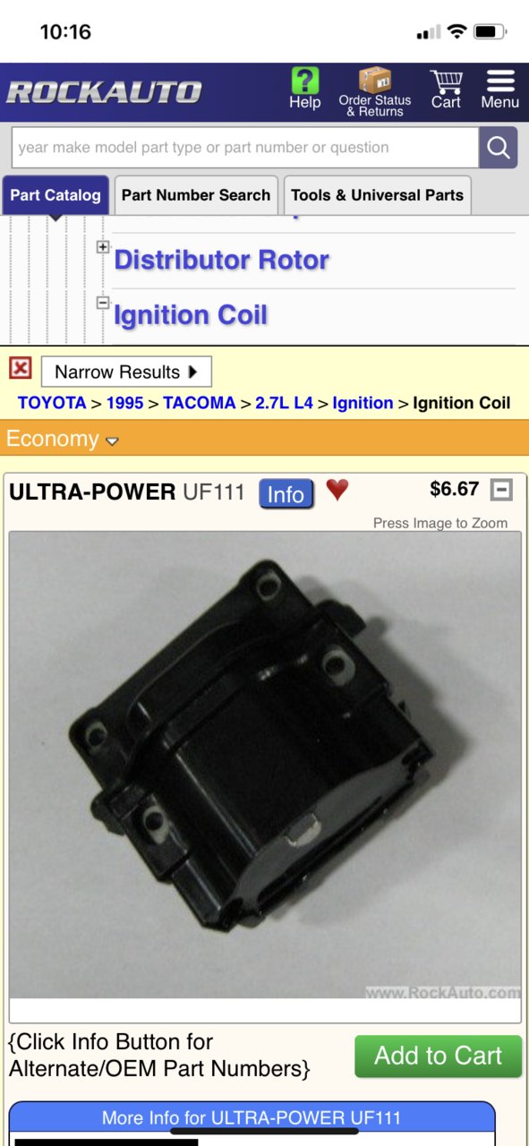

    2000 Tacoma 4wd ex cab 3.4 auto.. manual hub, J shift
    Not at all familiar with the early 2.7 but this is what rock-auto showsB85CE326-F6E6-4B12-8D2B-9816BFDD3796.jpg

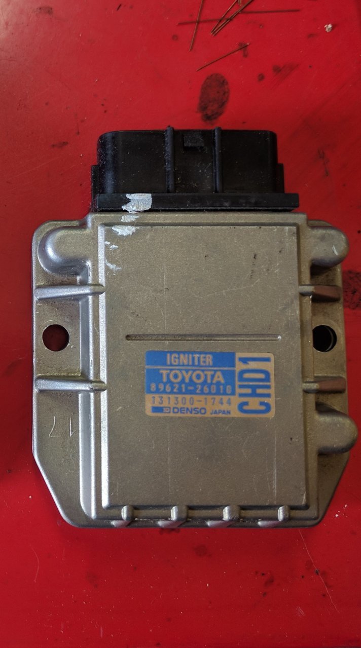

    There is no coil you have a igniter and your distributor .
    the coil is combined in the distributor looking nothing like the round cylinder your thinking of.
    The igniter should be on the right inner fender been a few years since I had one in front of me

    95-97 4cyl ignitor
