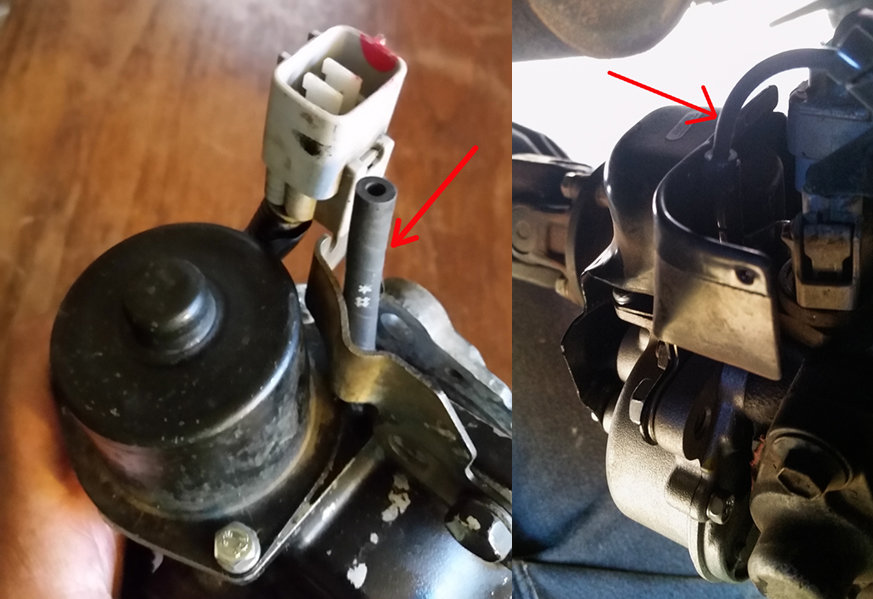

    Here's the breather on my '02, same as on my old '01 - off & on the truck.

    Well I'll be damned.
    I just crawled under my truck to check this out again, and low and behold...
    I guess my just skipped right over it all these years and never considered this. Guess I just assumes it was a wire.
    dblees and SR-71A like this.

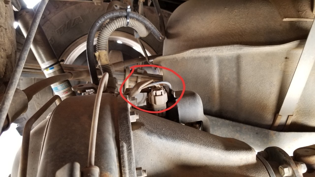

    Lol, my old thread . . . so are you guys SURE that it's electric and internal? If so, then why does the 5th Gen 4Runner have a breather for the locker? o_O
    I crawled under the Taco today, but I got pretty lost up there + there wasn't much room
    EDIT: I'm referring to 3rd Gens with factory e-lockers by the way
