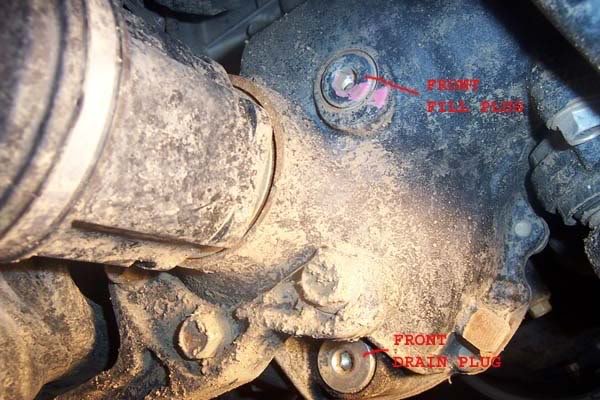

    Trying to change the front diff oil.
    I see the drain plug, but where the HELL is the fill plug?!
    Here is the drain plug. Shouldn't the fill plug be up and to the right?
    I have looked everywhere and cant find the damn thing!
    Please give me the answer!
    Thank you!

    its on the front of the diff. Cant miss it...

    I removed the front skid plate it was a lot easier to get to the fill plug. I suppose you can get to the fill plug with the right tool which I did not have.
    What's difficult is getting it back on. I found my skid plate was being held by 2 screws. Also note once you remove all the screws slide skid plate forward as its being held by two tabs.
    Good luck.

    Hi Guys,
    Thanks for the input!
    I just removed the skid plate and was able to find the fill plug!
    It was impossible to see it or get a wrench on it with my skid plate on.
    Hit it with PB and will hope it comes out easy later today.
    Thanks again all!
    D.

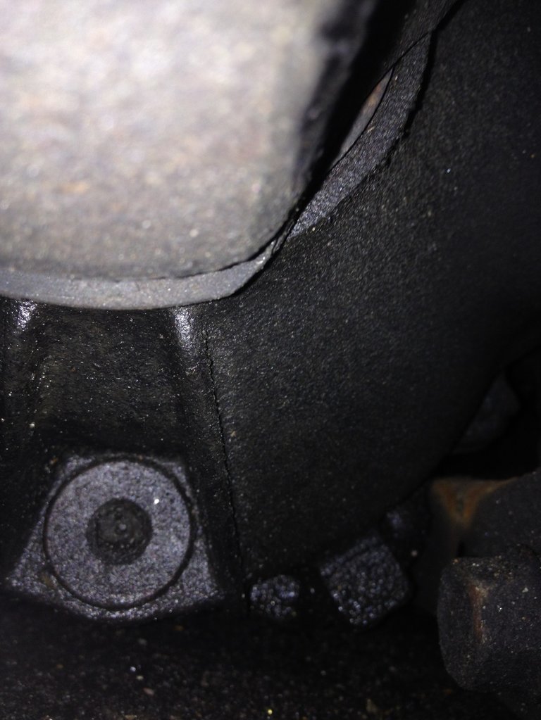

    Is that a crack in the front diff??

    ^haha ooooops

    It's less Tacoma and more mod
    Good eye, certainly looks like one. OP what do you think?

    I was gona say casting burr but looks like it doesnt follow the rib or anything..??

    Just changed the fluid today.
    I didn't notice a crack.
    I will double check tomorrow and report back.
