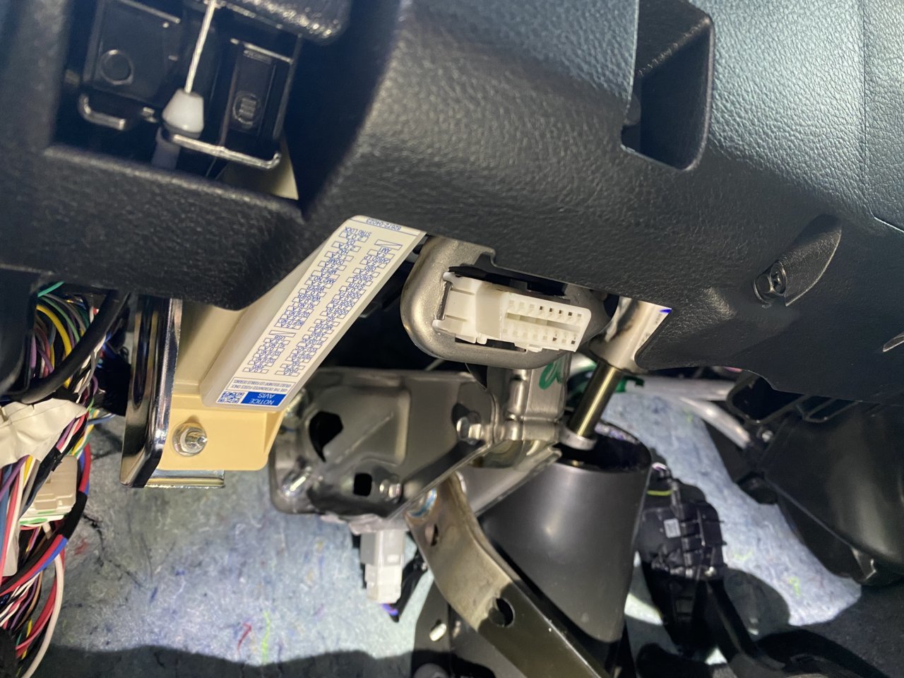

    Traded in a 2018 Tacoma for a 2021. Trying to transfer Tekonsha Prímula IQ OEM Brake controller, with same adapter wire.
    I can’t find anything anywhere in the inter webs that says the 2021 is any different from other 3rd Gen, but I can’t find the OEM brake controller plug where is was in the 2018, and there is a new plug I don’t recognize under the steering column. I was hoping I was lucky and it’s a better placed plug... but it doesn’t fit my adapter.
    Is this plug under the steering column the OEM plug? If so, which adapter do I need? Sites all show the same adapter for 2016+ Thanks

    If it came with the factory tow package you should find it behind the tangle of wires circled in yellow.

    That is what I expected... I looked all over, no luck. I’ll keep trying, thanks! Any idea what that socket is under the steering wheel?

    That's your OBDII port... Unless you're joking due to today's Friday thread.

    Trace these wires... they look like the right quantity (4), the right colors (blue, red, white, black) and size...
