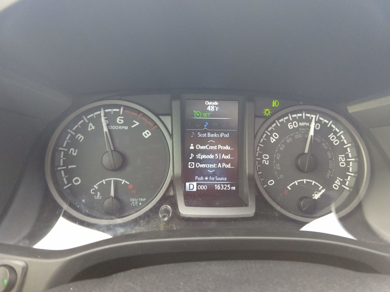

    OP, As far as mountain driving here in the PNW goes. I'm always in the higher RPM's. Just like this photo from @eurowner. Whether that's driving up a long steep mountain grade or engine breaking on the way down. I exclusively use S-Mode, ETC to avoid disappointment and to stay in control with the right gear. I don't find this embarrassing like when it happens in the city, passing someone. Keep your manual in a gear on mountain grades that's appropriate for the conditions.
