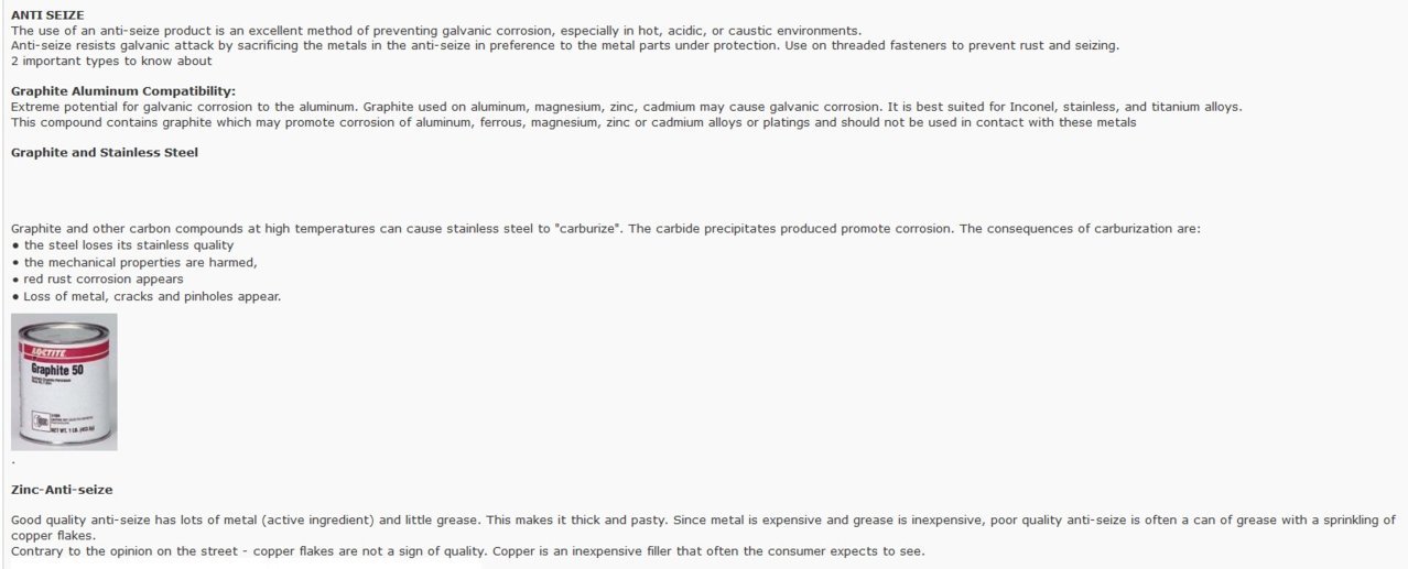

    I came across this the other day, apparently it contains graphite which can cause corrosion and carburize at high temperatures
    Maybe copper anti seize would be better?
    https://dodgeforum.com/forum/3rd-gen-ram-tech/250693-dry-torque-wet-torque-and-anti-seize-fyi.html
