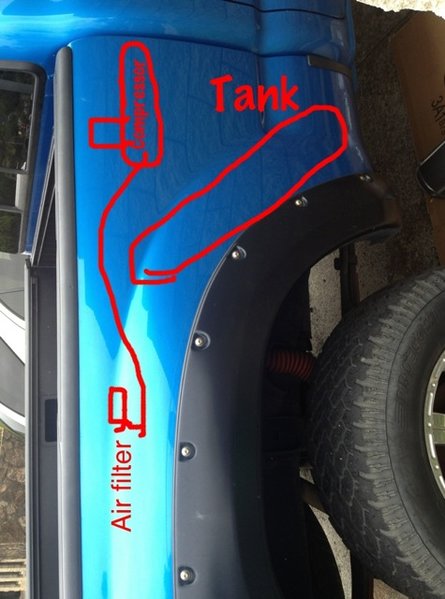

    At least I'm not the only one thinking that, but I don't want to move my spare and I need to fit in parking garages or the rack would have worked! I took another look and I think I found a solution. Inside the right rear fender forward of the tire. Looks like it will fit but I'm a few drinks in. Now I have to figure how to support the weight in a space with no right angles and only 2 useable sides to mount to. Has anyone heard of this being done before?

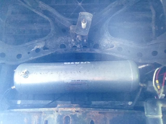

    In between the rear bumper and spare tire carrier. I also put my compressor next to it. Put the switch gauge combo and the compressor intake filter into my driver side bed box

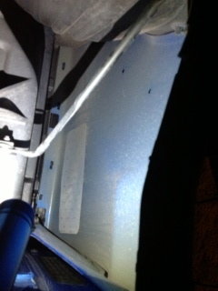

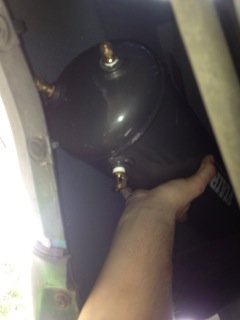

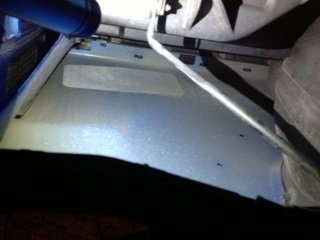

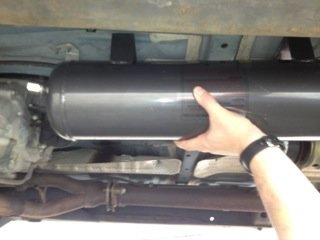

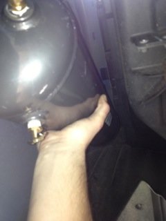

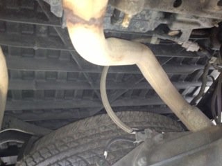

    not so well, im assuming you were talking about in front of the spare above the axle. i have dual exhaust that runs in my way. if i went behind the spare i wouldnt have access to the raise/lower chuck for the spare. and on top of that i have a plastic bed that has support beam i would have to cut in order to make it fit with about a 3-4" spacer holding the spare. i have included some photos of options that i think might work. easiest option is currently under the drivers seat. the difficult but smarter option would be inside the RR fender in front of the wheel. it fits in there nicely with plenty of room. however there is no easy way of mounting it. as there are no right angles and once its installed i wont be able to access the top 2 mounting bolts. if i go this route i will have to remove the fender, fab out a bracket thats strong enough (without a welder or a vice) install fix any leaks and then reinstall the fender. i have removed front fenders before and it wasnt that hard to get everything lined up again but i feel this will be extremely difficult.
    has anyone removed rear fenders before? advice?

    more photos of what im thinking... remote air filter next to the box above the wheel well to easily change the filter

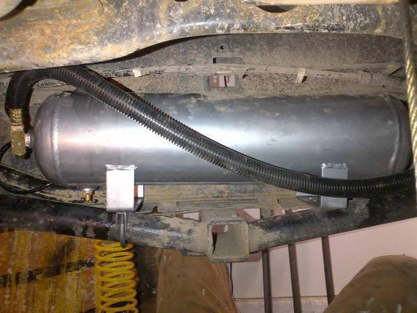

    I just mounted my Viair last week, I have an aftermarket hitch and used 1 3/4" muffler clamps to secure the tank to the hitch. Works like a hot damn! You could do something similar with a bracket bolted to the bed or the bumper. There is still plenty of room for the spare and it's low enough that i can still use the stock tools to lower the spare.

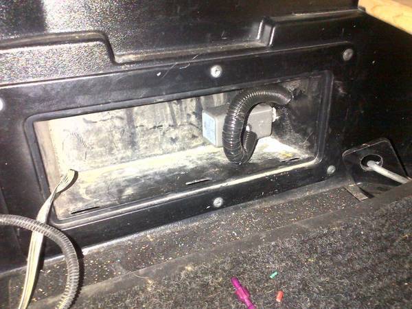

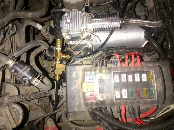

    Compressor as you say in the engine bay behind the fuse box with the remote inlet taking air from the cab, pressure switch in the rear cubby.

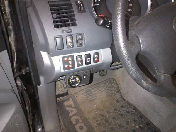

    I plan on getting a gauge pod for the psi gauge, but for now I just removed the fuse cover and zip tied the gauge in place.
