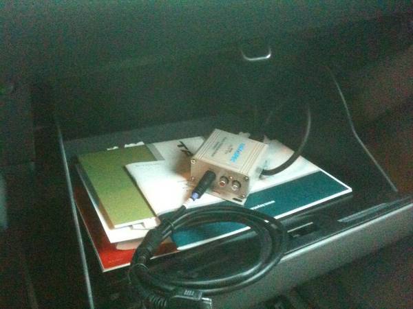

    I ran mine into the glove box. From there, I run the connector cable out the bottom of the glove box door to a Bracketron universal mount I have double-sided to the interior wall of the cubby in front of the shift handle.
    This way, I can have my iPhone visible for maps, etc, but under the dash from the po-po, or I can stuff the cord into the glove box and keep it hidden. (minus the Bracketron, of course)
    I think I might have pics in my gallery.

    Like this.

    terrible installation job :facepalm:

    Porque?

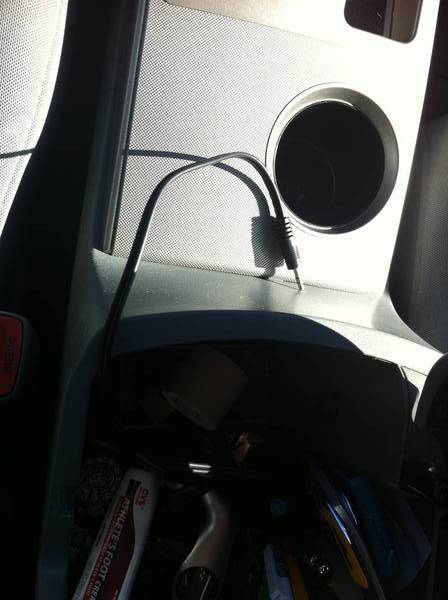

    the actual box is in the glove box
    ipod wire in the center console
    the Aux wire is right up in front of the shifter in that cubby in front of the cup holers

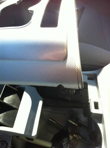

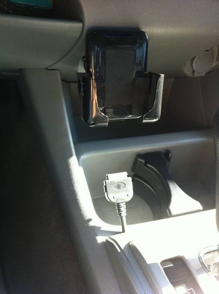

    I pulled it just above the 2 cup holders between the shifting housing. Its in reach of my Iphone holder that plugs into the cigarette lighter.
    I cut out a small groove to fit the cable and it slides up and down, no problem. I plan on making it retractable by hot-gluing a strip of elastic band to the cord and to the inside compartment.
    Here is the groove on the top piece. The bottom also required a bit of cutting.
    I also bought the 3mm jack adaptor and ran that to the center console just as the previous posts here.

    I wouldn't have that converter box inside the glove box. Maybe mount it hidden up under the dash. I would drill a hole in the back of the glove box so that you could run the cable that you connect the ipod to through it. Then you could pull the cord out when you need it, and tuck the cord into the hole, when you dont. That way you wouldn't have all that junk in your way anytime you need to grab something from the glove box
