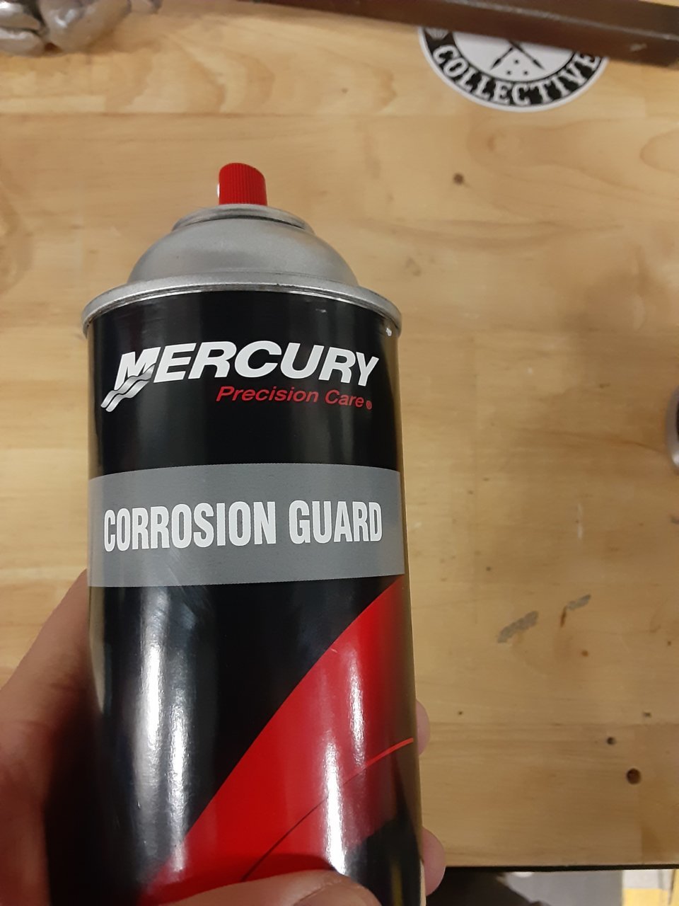

    20210510_081309.jpg I'm thinking of trying this stuff out. Have a whole case of it at work. Corrosion and rust inhibiting. I'm guessing its similar to fluid film?
  16. May 10, 2021 at 8:53 AM
    #56
    Shades_Of_Red
    Shades_Of_Red Well-Known Member
    May 2, 2009
    #16713
    2,165
    Lou
    Pittsburgh, PA
    2019 Tacoma TRD Off Road Premium Cavalry Blue
    A few.
    Sounds famliar. Years ago My dad used to take used motor oil thin it kerosene and spray it under his f150 using a long nozzle connected to the air compressor
