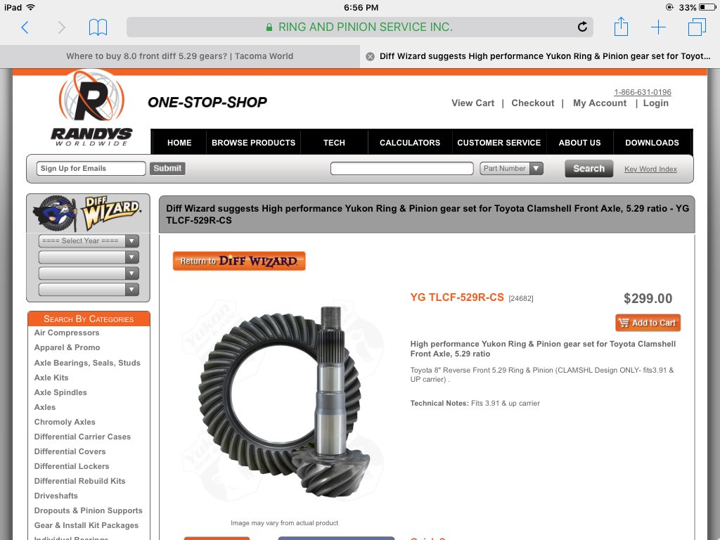

    Want to regear my 2nd gen v6 to 5.29 gears. Found some for the rear, anyone know where to find them for the front?

    ecgs only goes to 4.88:pout:

  6. Sep 14, 2017 at 6:57 PM
    Oreo Cat
    Oreo Cat [OP] Worst Member
    Sep 19, 2016
    #197755
    5,351
    Coeur d’Alene, Idaho
  7. Sep 14, 2017 at 7:06 PM

    FITS 3.91 and up carrier..... FYI your v6 came with a 3.73 so i dont think those gears will work for ya.

    Which one has a 3.91?

    I thought 2nd gens cant use 5.29s at all

    I remember someone saying once that only 1st gens can run 5.29s and 2nd gens are limited to 4.88s. maybe im making it up tho?

    37's on a 8" 5.29 ring gear, not sure how long before you have little teeth and gear oil soup in there *bang*

    2nd gens didnt. only 3.73 and 4.10 (4cyl 4x4).... but both of those used the same exact clamshell... needless to say i dont think you are running anything bigger than 4.88's
