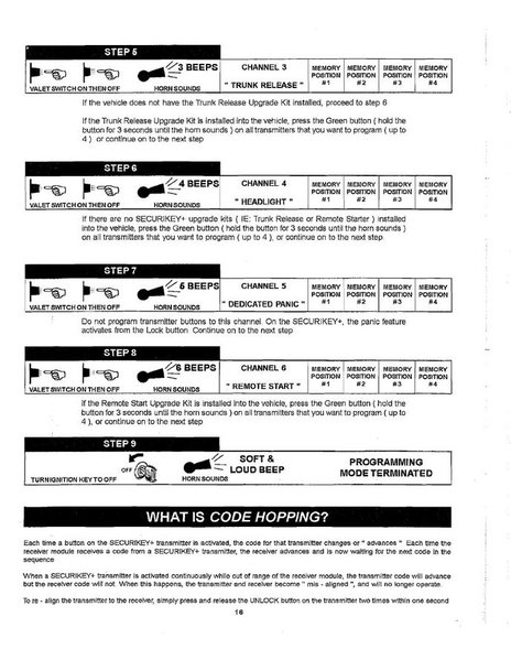

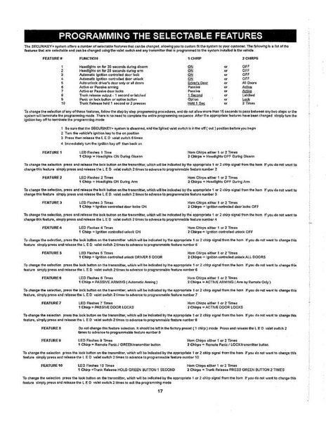

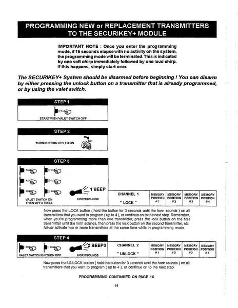

    While looking for a new FOB for the Securikey+ alarm, I found the following information on how to program the alarm. I wanted to share it incase anyone has to reprogram their alarm.

    I received and programmed my FOB yesterday. It works perfectly except I have to use a different button than what is on the remote to unlock the doors.
    I am going to try again this weekend and see if I can fix this problem.
