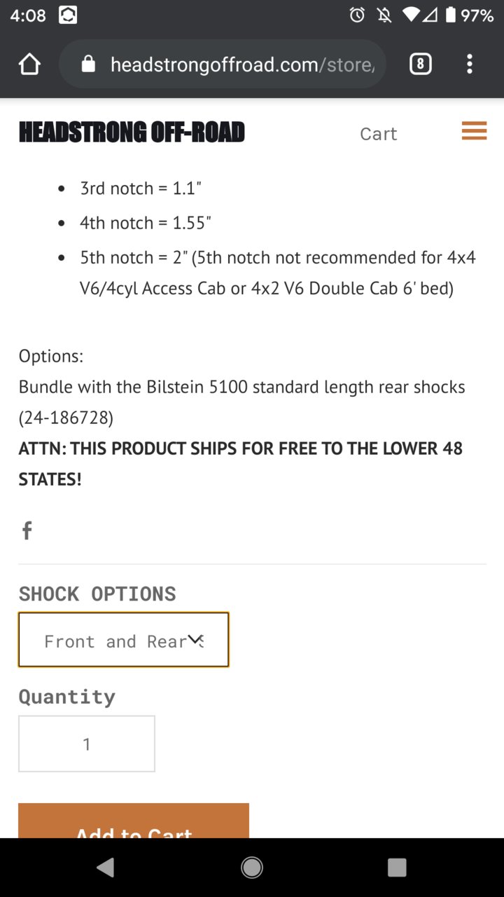

    The 6112s showed up today. Set at the 4 and 3 notch. Got em on and I’ll take it down tomorrow or Saturday for alignment. Instal was easy. I have an AAL but I don’t want to use it lol. The measurements say it’s level up front at 36 3/4 and the back hovering at 37 pass and 36 3/4 driver. I’ll see how it looks after alignment and decide on the rear leaf or not. I don’t really want a rear lift. I took it for a short drive. Feels good no vibrations or anything negative. Think it needs the leaf?

    I don't think you need the AAL, but hard to say for sure without a pic taken directly from the side looking at the drivers (or passenger) side profile.
    How much lift did that setting get you for the fronts and did you measure after driving it around?

    There 265/70/17 and it shows 1.25 of lift. Itl Settle I’m sure. I didn’t drive it far enough to do anything. I drove down the end of the driveway to level ground and took a couple pics. I’ll get it aligned and give it a week or so to do its thing and then make decision on the leaf.

    I'm super curious if it will settle down to about 1 inch by the time you get home from that alignment.
    If you don't mind, keep us updated and post your alignment sheet.
    That would help me decide where to set mine! I will probably install my parts next week.
