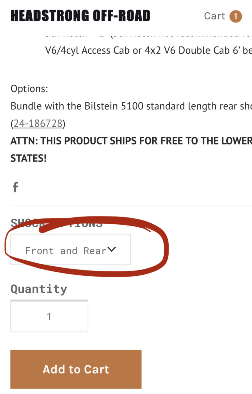

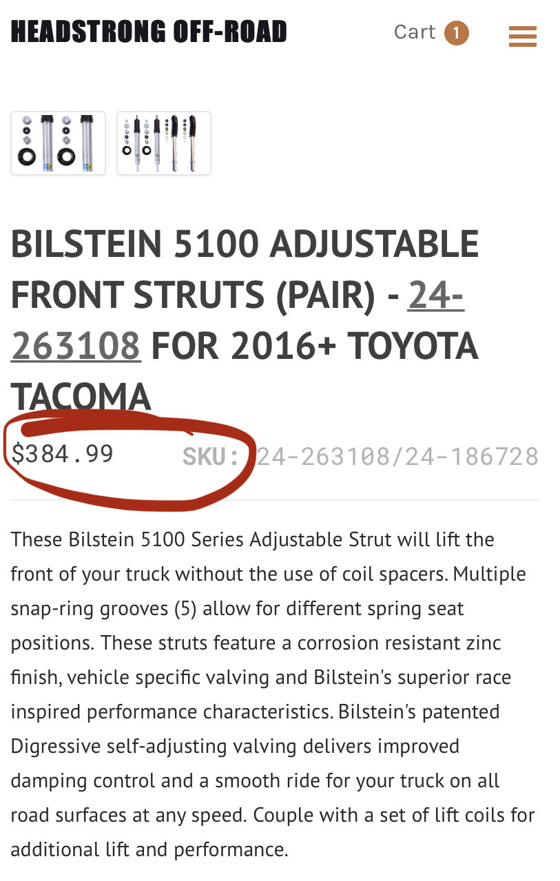

    The drop down can be misleading, select front AND rear on headstrong.
    You’ll notice the numbers change to $384.99, it will still look weird in the cart though. But the change in price is your confirmation.

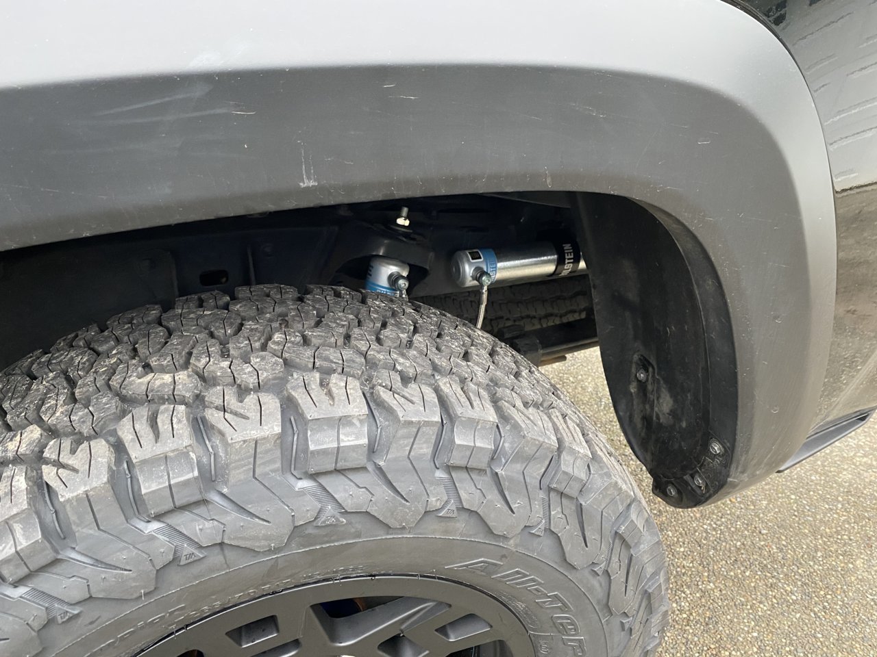

    Yes 1in according to the chart. I’m showing 1.25 now, It will settle a tad I’m sure. No ecgs, I have the suspension in as of yesterday and it feels the same there’s no vibrations or any “new” weird feelings. It gets into the shop tomorrow at noon for an alignment..

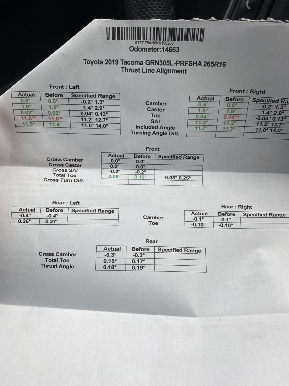

    This is the alignment sheet. Keep in mind it’s only 1in of lift upfront.. I have the firestone lifetime alignment. I’m not too hip on what all the numbers mean. I know what caster camber is and what toe is.. truck looks and drives fine at speeds up to 70. Tracks good drives straight no wandering. Let me know what you guys think
    he mentioned the SAI not being a concern being off .2 on the left. Seemed weird to me but we will see. Can always take it back.

    Disclaimer: I am not an alignment tech.
    He probably could have gotten SAI within spec by pushing the lower control arm slightly forward (more caster), but then he'd have to adjust the caster on the other side to match, too. Plus he'd probably have to adjust camber on both sides as well once he started changing the caster...
    So it looks like he basically fixed your toe settings and called it good since nearly everything else was still within good specs.
    If you aren't having a problem with the steering returning to center or the vehicle tracking straight then it probably isn't a big deal.

    Yea makes sense. I asked him how it went before I saw the sheet and he said he just fixed the toe. And that it was all still within spec from the lift. He pointed out the SAI and said that “the difference isn’t anything to be concerned about” and that it played little into any tire wear or part wear.. I didn’t argue and just said cool and drove off.. drive drives Killer and feels great on the road.. I’m happy with the choices and now I have to find something else to drain my wallet.. :spending:
