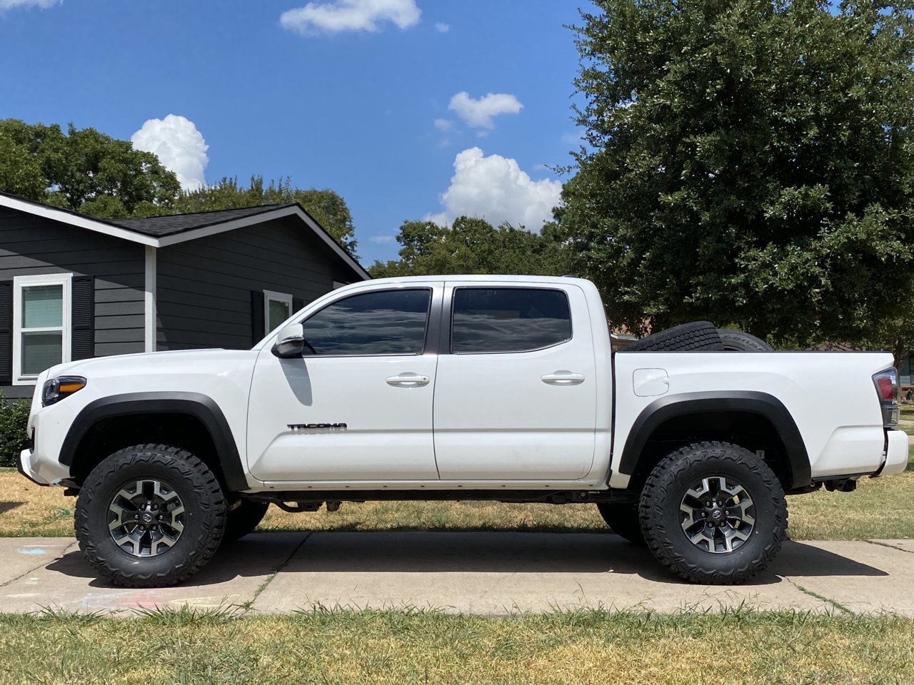

    I will. I just put the spacer kit on now so I could clear 285 75 16 MTs — pretty straight forward. Excited to make it ride super nice next. Look is on point. Sleek powder coated bolt on Rock sliders on order from @CaliRaisedLed too. Need a winch bumper and we good
    Will either wait for bds to drop a nice coilover kit for the 2020 or do bilsteins

    Looks damn good.
