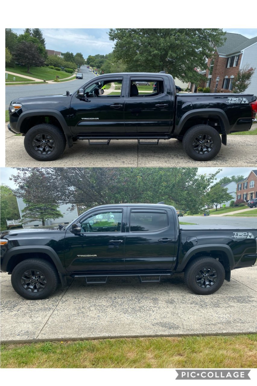

    Ironman Stage 1 Foam Cell Pro lift kit, 255/85/16 Cooper ST Maxx, SCS BR6 Wheels, SPC UCA, Heated seats, MESO TRD start button, Meso Total Tail v1, Meso V5 mirror white DRL turns, bed decal, ditch and hidden bumper lights, screen protech, RAV4 radio knobs, steering wheel anytime camera kit, dash cam, ECGS bushing, Timbren Active Off Road bump stops with Wheelers flip kit. 35% Xpel CS Ceramic Tint, KD Max Tune, SumoSprings front bump stops, RRW Sliders ‌ ‌ ▲ ▲‌ ▲
    Thanks for the info. I’ll definitely have to take it into account. I do have stock UCAs, for now. I will upgrade to JBAs at some point. I’ve got the Ironman Foam Cell Pro and it gave me about 3” with where I have it set now. I’m sure sure I’m leaving it there and I’ll need to double check on the droop. I don’t remember them touching but didn’t make a mental note. I had my alignment scheduled for tomorrow but had to cancel and going to wait 14 days before I’ll go in. Luckily Firestone is going to honor the $40 off lifetime alignment Labor Day deal.
    So far really happy. I know everyone says this about their lift, but feels much better than stock. You still feel bumps but they are really smoothed out, driving at 50+ is really smooth. There is really no dip while stopping, and feel more stable. I’m waiting till I get more miles for a really good review since I’ve not even gotten over 200 miles on it yet. I can’t compare it to any other lifts but maybe once ill let others in my truck I’ll let someone with another lift ride in it.
