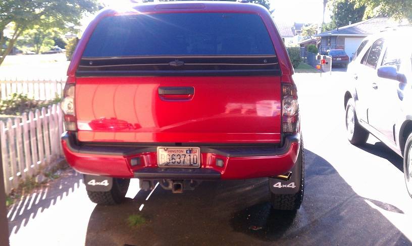

    i used to have chrome but i painted mine. sanded with 180 grit then 320 grit. used a self etching primer, normal primer, paint and clear coat.

    That looks really good. What kind of paint did you use? Duplicolor?

    looks a lot shinier than mine. nice :thumbsup:

    SICK, wondering if I can do something similar to my front bumper (OE plastic :( ). For sure would like to do this to my rear though (chrome). NICE WORK.

    i got my paint from automotivetouchup.com. you can paint your front plastic bumper. just make sure when painting plastic you use an adhesion promoter before you prime. when you sand chrome with the 180 and 320 you need to use a self etching primer so it will stick to the bare metal because chrome is a treated metal surface it is less "tacky". automotivetouchup.com has great instructions for painting and they sell everything you need...except self etching primer. you can get self etching primer at any auto part store.

    i removed the bumper to paint it. 6 bolts around the trailer hitch area to take out..3 on each side, two bolts under the black plastic piece that sits on the middle of the bumper under the license plate. once its off then you remove the plastic trim.
