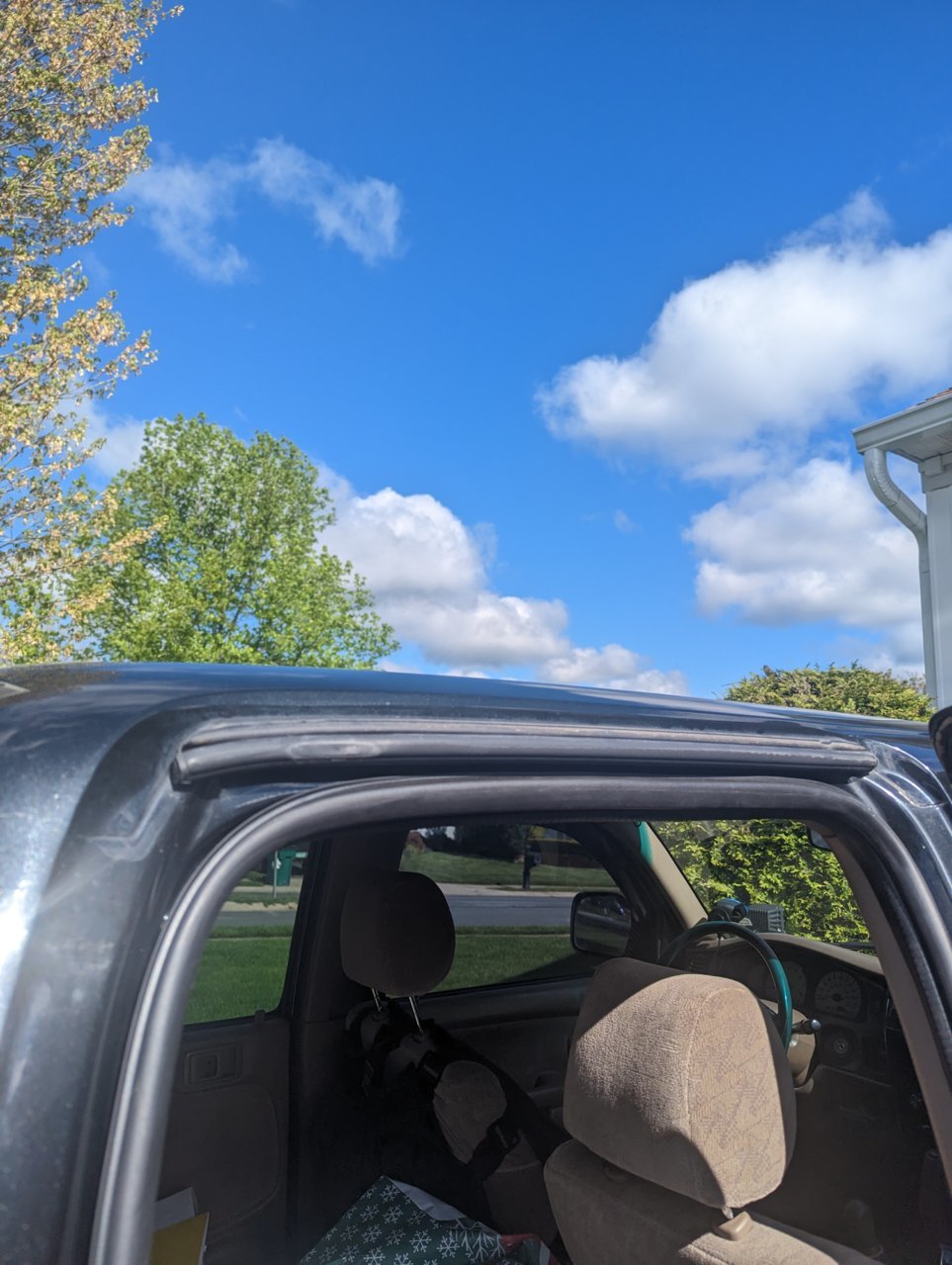

    Hey everyone. Bumping this up because I'm still leaking water. I think the culprits are the drip rail seal at the top of the door. Not sure the official name or part number so if anyone has that, it would be helpful.

    You still having good luck with this Greg? @Yota X I saw you mention you had issues with an aftermarket brand? Once I fix my firewall I want to see if some water I have splashing in the cab is coming past the door seals.

    Yeah these have been great. Followed the same oem design, left and right door specific, and had the right style "seal". Doors now pop open and take two times to shut. Highly recommend.
