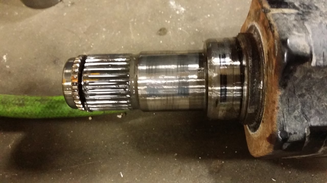

    Personally i dont see how you can not have the vibration after lift. Its real easy to check how tight your axle is held. Go to passanger side and grab the axle before it goes into your diff. Try to move it up and down. This is how tight an axle should be.
    Now go to drivers side. Do the same thing. Bet this axle moves up and down noticeably. This is because of the play in the needle bearing. Replace it because its so much easier when you have everything apart for lift and only cost 60.
    And their puller tool looks hella cheesy. Any 3 or 4 jaw puller will be a gazillion times easier and usually cheaper. Oh and you can use it on other stuff. Or return it to autozone and get your beer money back

    Well with shock asembly out of the way and spindle half undone, pulling an axle is little more than removing the axle nut. Or you can risk it and end up pulling it all out 500 miles later after the washing machine drone drives you nutty. Ask me how i know. Oh and at 7000 miles my axle was noticeable worn from moving around

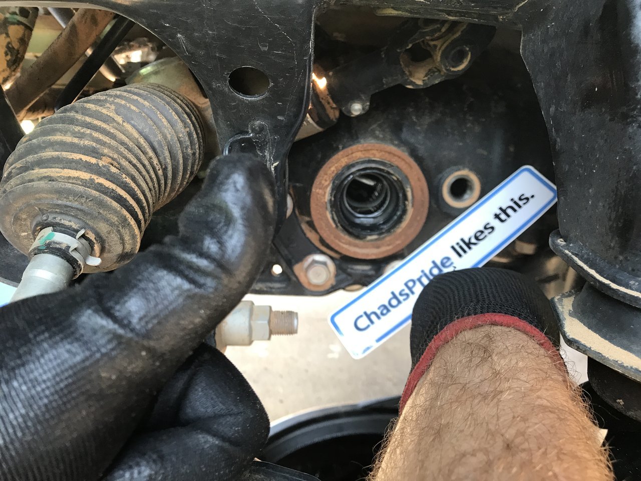

    #16
    17taco4x4
    17taco4x4 FZJ80
    Mar 9, 2017
    #212810
    1,451
    Orlando
    Porter, TX
    1997 Land Cruiser
    Did mine last Saturday along with the OME lift. Thanks to help from @fajitas21 and Chris and warren. Even was liked by @ChadsPride IMG_0368.jpg
