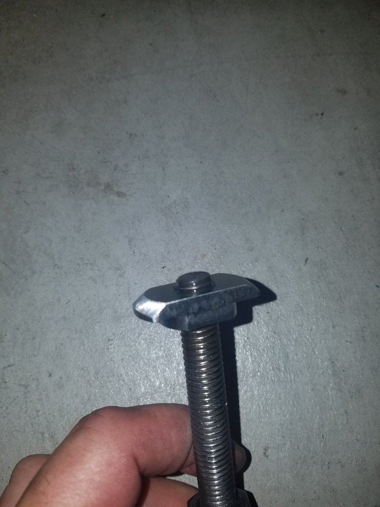

    I did mine as well at the same time I did my lift. In my opinion, well worth the extra 30min and 60 bucks to prevent having to take it back apart again. I didn't buy the tool, ended up making one out of a 6.0 power stroke headbolt and some angle iron. It's hideous but it worked!
