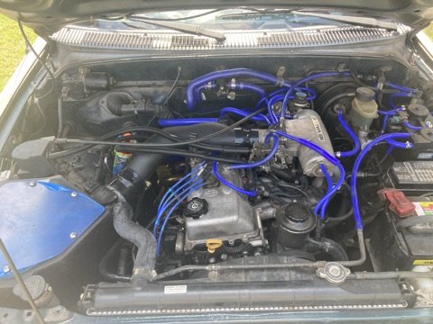

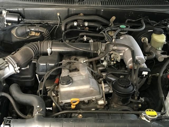

    Are you sure that engine will work in your engine compartment...
    I have 98 Rwd DLx ext cab AT Sr5.....I just swapped out a 3rz (toast) to a rebuild 2Rz...
    My engine layout does not look even close to the layout on that jdm pic...
    I'll upload my before & after pics after sort them out....
    but air induct is completely diff, the steel lines are all diff, ie egr line..
    this one has coil over plug design ...like the early 2000's...
    everthing would have to moved from the old to it, its doable, but its gonna cost and take time...
    someone else chime in .... maybe I'm wrong about all this....
    This is stock photo of mine....

    The Jdm engine in that pic looks like the one in 2004 base 2.7 AT Rwd....
    Mike at work has one ....he couldn't find his coils...I told em they're sitting right on top each plug....

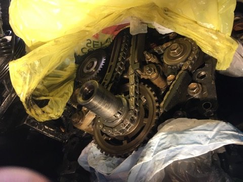

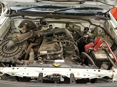

    You should read my messages that I posted early.. in this instance you are incorrect.
    2005 Toyota 2.7 is a 2TR FE engine not the 2.7 3RZ FE 3ngine that is in our 1st gen tacomas. The engine he linked is absolutely a 3RZ (or 2RZ, but highly unlikely) the valve cover is a dead giveaway. The 2TR looks like this

    but this is the ultimate balance-shaft-delete.......two timing chains?...really toyota?
    The balance shafts rob power...2Rz feels same power as the 3rz....i could feel no difference...especially with the after market headers........the cast iron originals always crack...eventually.......throws fuel trim off.

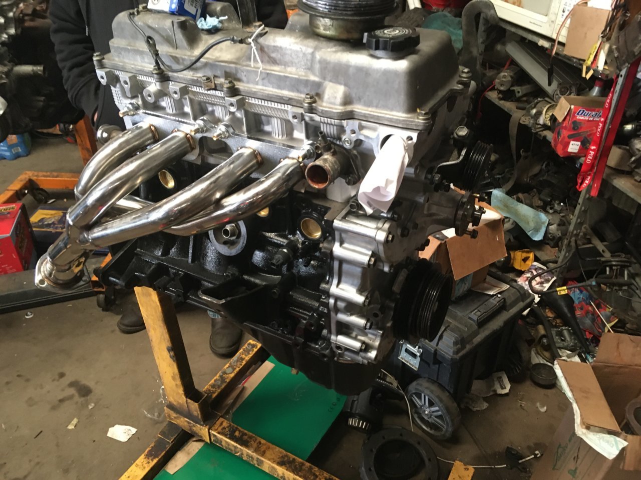

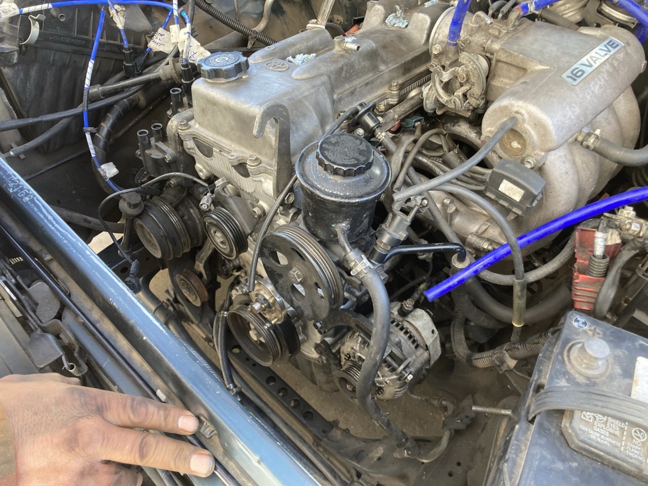

    Before.....
  16. Aug 28, 2021 at 3:12 PM
    #56
    O'Silver_Taco
    O'Silver_Taco Well-Known Member
    Aug 26, 2021
    #375390
    4,155
    MD
    98 Dlx Sr5 ext AT Rwd
    3rz to 2Rz bebuilt block and new heads
    After.....
