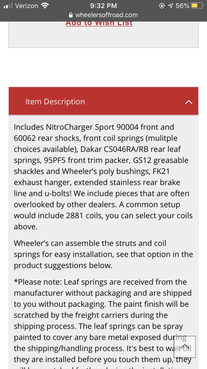

    Doesn’t the wheelers kit come with brake lines?

    The wheelers website says it comes with extended stainless brake lines

    The kit from wheelers does come with an extended rear brake line

    yes and Wheelers also includes (over the standard kit):
    95PF5 front trim packer
    GS12 greasable shackles & Wheeler’s poly bushings
    FK21 exhaust hanger
    extended stainless rear brake line
