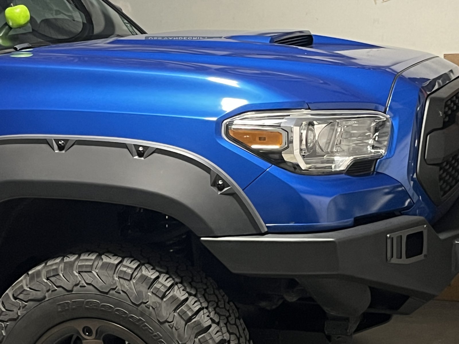

    Took a few tries but I figured out how to match the blazing blue! It was not easy even with the exact match paint. So, anyways, from what I hear Ya saying you may want to just have a body shop take care of your repair. I used Touch Up Direct. I think the paint kit cost me about 100 bucks.
