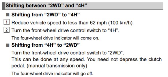

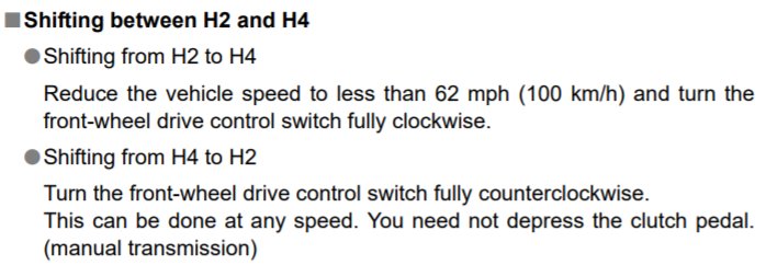

    Flip the switch at 80, it won't do anything but flash the light at you. Flip the switch at 60 (62?) or lower and on a straight piece of road it engages perfectly fine. Everything is already spinning. Should not cause an issue. I just realized this is 3rd gen section, is it different on them? I may have made an incorrect assumption.
    EDIT: from 2nd gen manual
    And another EDIT: 2019 manual
