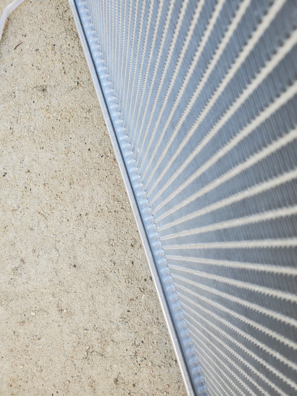

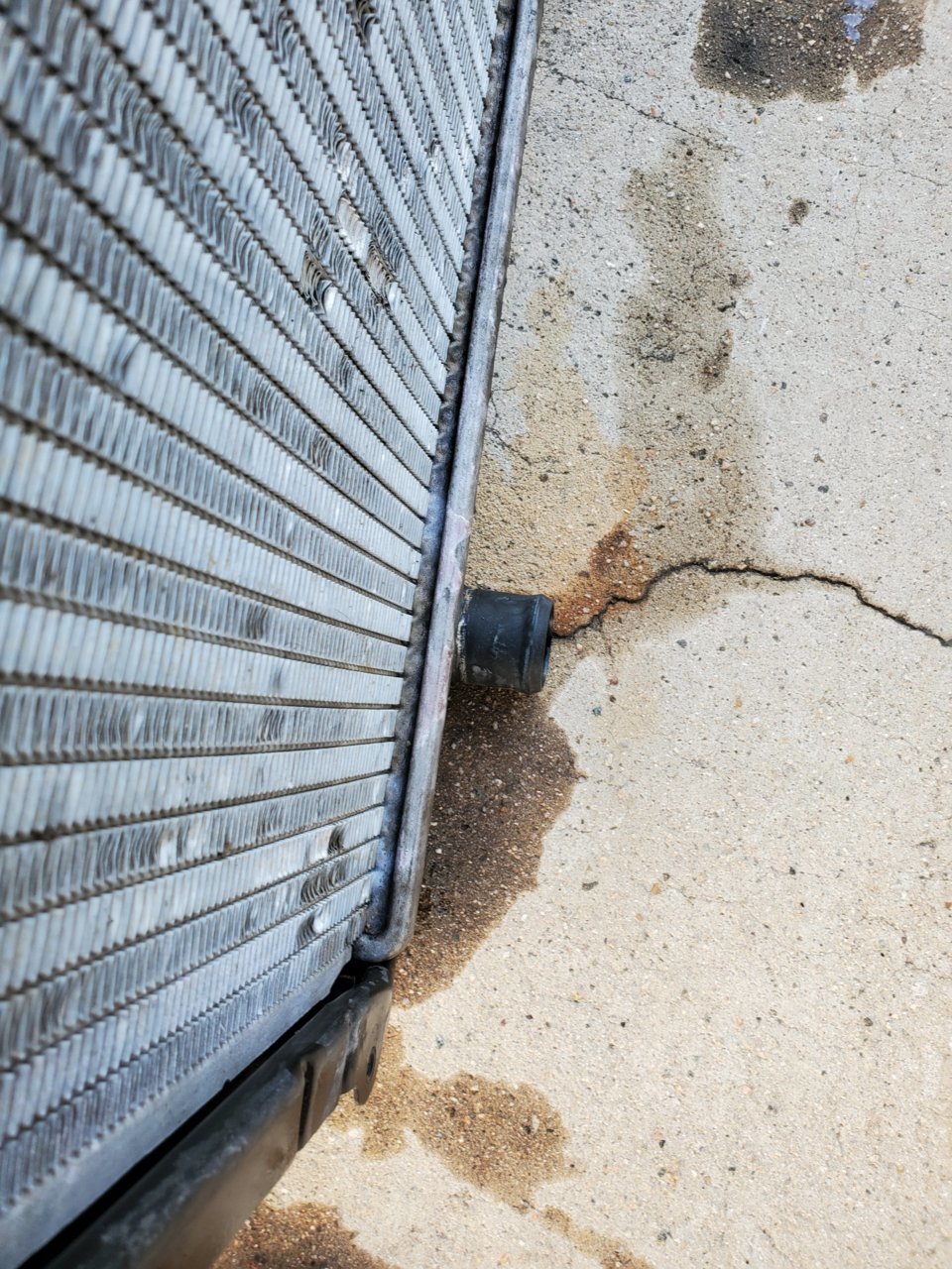

    Great information everyone.
    Finally, my Harrison radiator when out :( . After reading some of the threads on this someone I think mentioned mishimoto radiator so I went ahead and ordered and it arrived damaged. They are currently sending me another unit, but I figure I can maybe use the damaged radiator in the meantime as I'm helping out my mother in law close down her business. I don't drive that much so normally I will just have it sit there until I get the correct parts, but now I'm thinking of returning, after comparing the harrision with a new radiator. There is no comparison that harrison radiator is built, as you can see from the below pics the Mishimoto radiator core is thin maybe a 1inch. I didn't really pay attention to this when ordering, so now I'm trying to get another radiator by tomorrow but from what I can see all the radiators are 1 inch except for the denso.
    So my question anyone knows where I can source a thicker core than radiator locally here in the los angeles area? I checked autozone, napa, pepbosy and their all 1 inch thick cores.

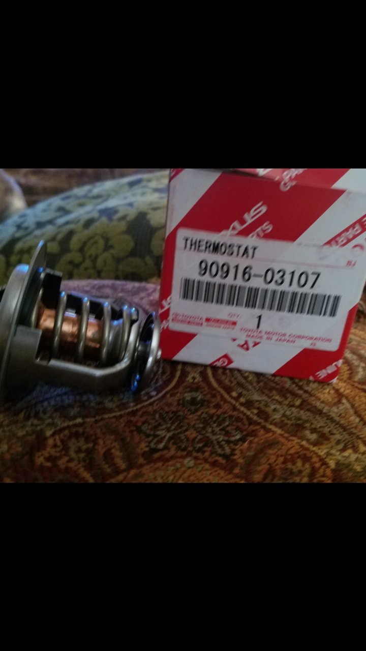

    My temperature with the 170 OEM Corolla
    Stat
