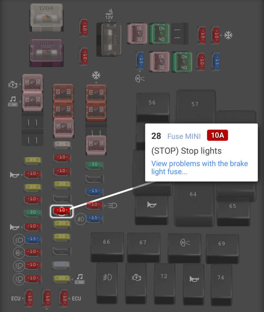

    Is there a source any of yall know for these pig tails? I have more issues than just this pig tail
    but i do need one of these pig tails any way, so im starting with the pig tail and will go from
    there. I found a STOP fuse under the hood is this the brake light fuse and is there another
    fuse somewhere else? Hopefully there is some source for elctrical stuff like this and maybe
    even harnesses for our Tacos.
    Thanks
    Ron

    Let’s start with the Fuse list, see attached. Suggest you and others download it to your phone and computer.

    Well if you have an automatic and can shift it out of park then your STOP Fuse and Stop Lamp Switch have to be good so it would have to be a wiring/connector/bulb issue.

    Is the trailer plug stop circuit a separate circuit from the taillights? @caribe makaira would definitely know that. @ronmat do you have a meter or test light? I am wondering if there is even 12V getting back to the lights. Have you checked this fuse?
