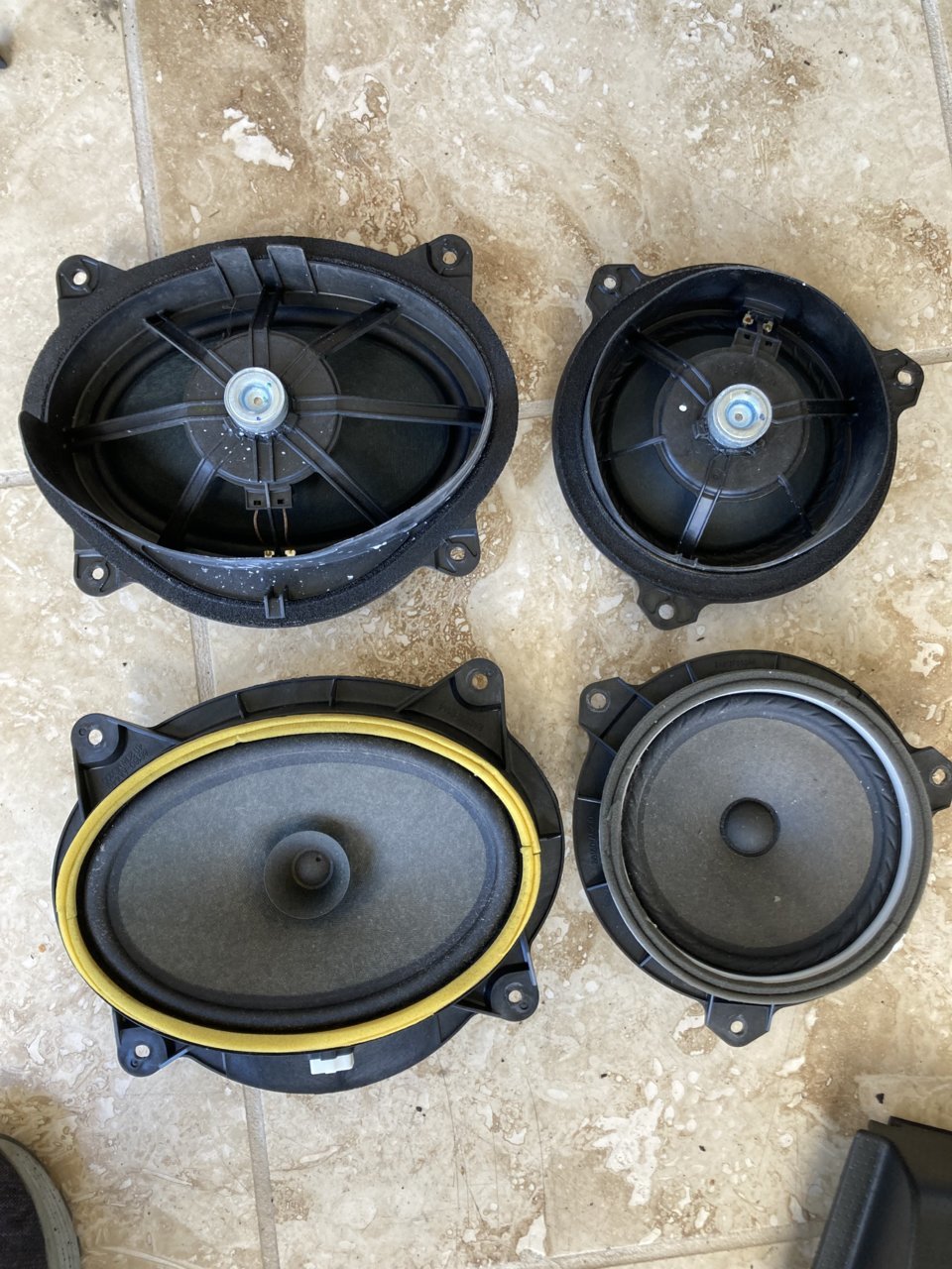

    I don't have sensitivity or frequency range, but here's what I do have for your truck.
    Front Tweeter: 2.6 in, 4.0 Ω, 17.5 W
    Front Full Range: 6 x 9 in, 4.0 Ω, 20.0 W
    Rear Full Range: 6.3 in, 4.0 Ω, 20.0 W
    Jeff
    nctacman and 007fodo like this.
  9. Mar 27, 2023 at 11:37 PM
    007fodo
    007fodo Gold Member
    Nov 1, 2016
    #201269
    280
    Ian
    Coastal North Central CA
    4X4 V6 5AT DCSB 07
    What Jeff said and there's a simple capacitor between the woofer and tweeter (soldered onto one lead to the tweeter) to separate frequencies, so if replacing with a woofer+tweeter kit you don't need to know the frequencies because you will get a new crossover... Unless you're getting into complicated waters and want to know where the factory speakers cross over because you're assuming Toyota chose a crossover point that gave the best sound profile for the interior of the cab...
