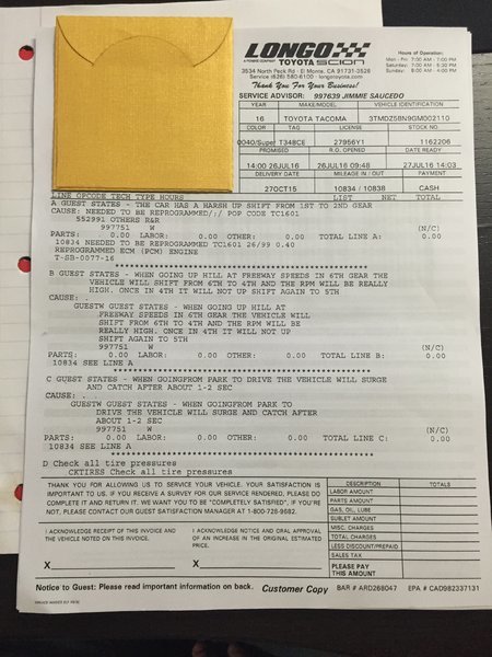

    Longo El Monte knows about the TSB and the low transmission fuel now. I dont know how hard it will be to get them to do it, I had to get my friends husband to look into it for me, who is the service manager there.

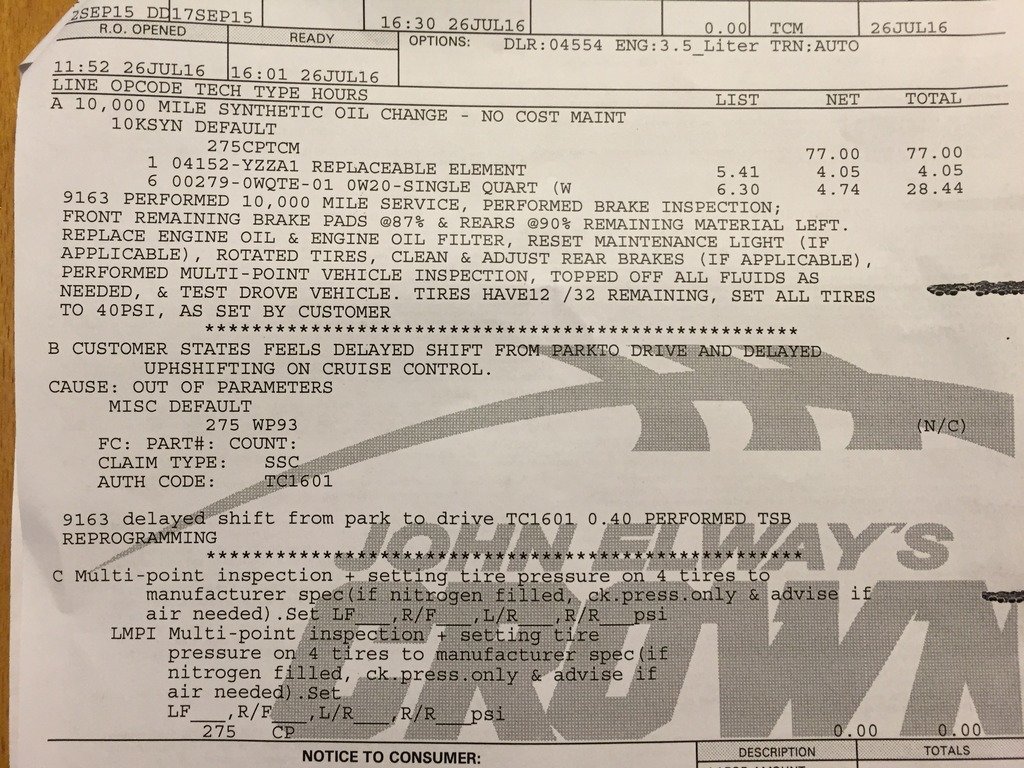

    Had my 10k service along with the TSB reprogramming performed at John Elway's Crown Toyota at the Ontario Auto Center. My service advisor noted she had already done a few of the TSBs and was aware of the issue. It's classified on my paperwork as TC1601 which is the OP Code for TSB-0077-16. I can definitely feel more responsive throttle off the line and holding the gear much better before shifting. Delay from reverse/neutral to drive is completely gone so far. I'll report back in a few days, but so far so good.

    TSB done! I didn't notice a ton of a difference yet, had a short 5 mile drive from there back to my work.

    Let's compare stickers. Shouldnt I have 3 codes? Does this mean I only got 2 out of 3 issues addressed?

    I didnt get a sticker. :( but after driving it all evening, i def can tell a difference. it will hold the lower gears instead of upshifting per before. i like it so far.
