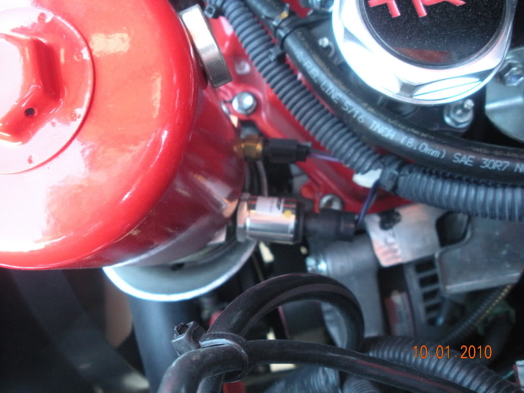

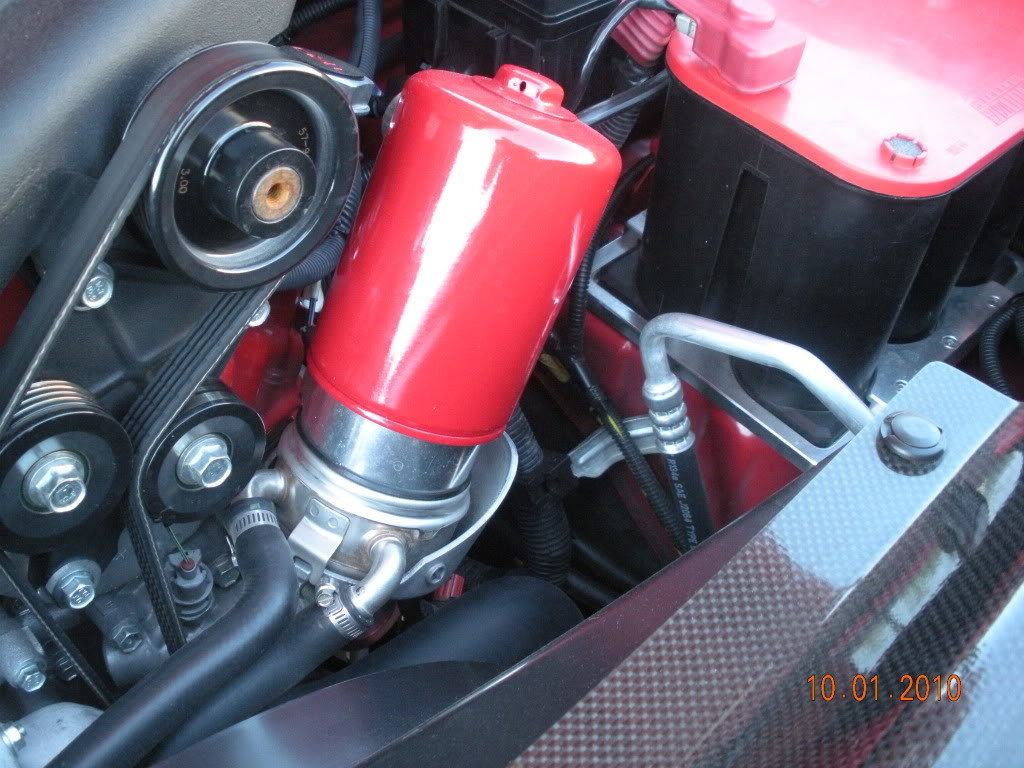

    For the record.
    Factory oil cooler, sandwich plate, Big ass filter, oil temp & oil press.

    Wow... I guess it does work. Well, I'll leave it as an option, since I have the oil temp sending unit sitting in a box. I'd hate to have spent the money and not use it. Still, people claiming leaky units bothers me (not necessarily on Toyotas).

    When you do the sandwich plate, you need to make sure the seal compresses. I have noticed some that the central bolt is a little too long. Mine had to be trimmed slightly.
