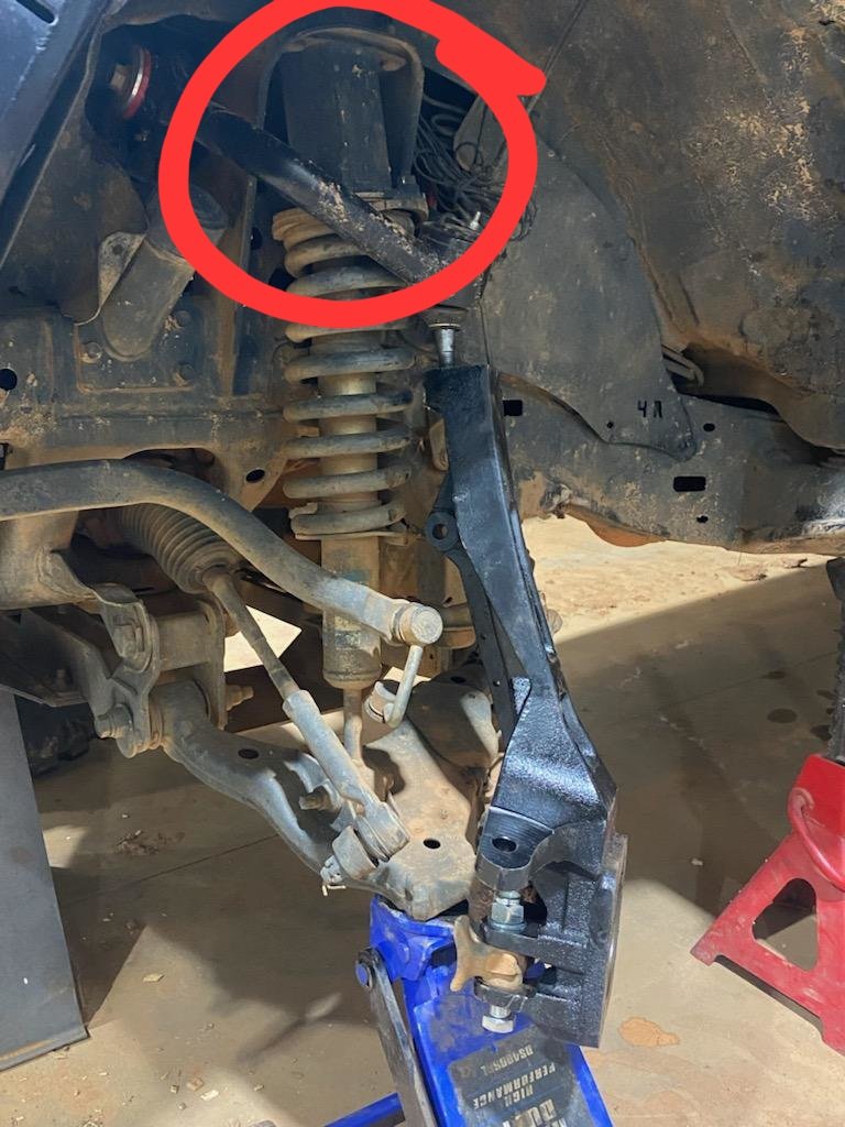

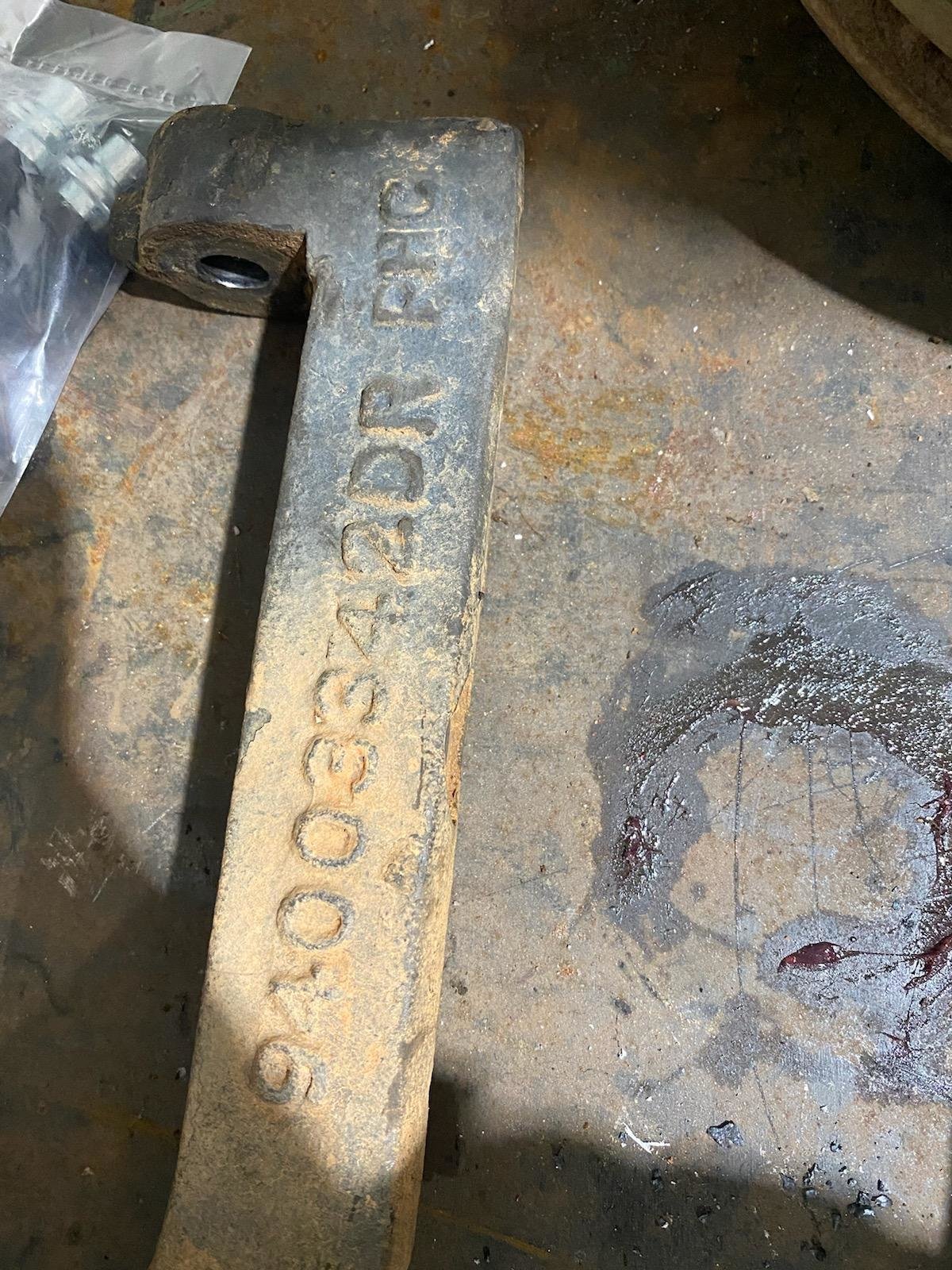

    Can someone please tell me where to get this part? Searched all over Google and can not find it by this number. Its a spindle for passenger side 07 Toyota tacoma. Thanks!

    That's most likely a casting number not a part number.
    There would only be 2 different spindles, depends if you have a 5 lug or a 6 lug truck.

    Ahh, okay! 6 lugs. Thank you!

    Looks like an aftermarket lift spindle to me.
    Is the truck 2WD and lifted?

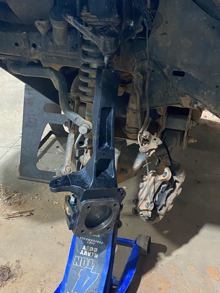

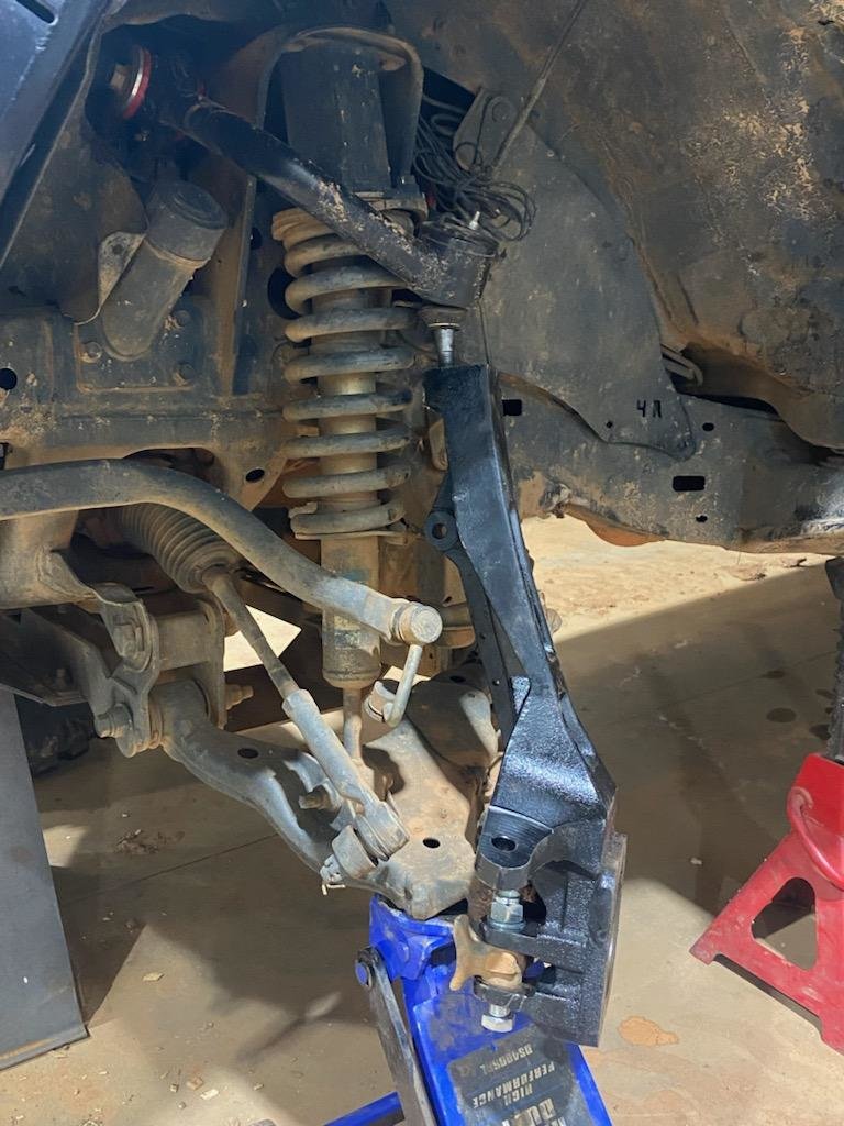

    Lower control arm won't go up anymore to connect the uca to the spindle it is a 4 inch lifted spindle on a 6 inch rc what could cause this?

    Your issue is the spring is not compressing, the spring is too stiff and just raising the vehicle when you jack it up.

    Are the lower control arm bolts loose?
    They should be.
    And if what you are saying is true.
    Then that means you have a 6” spacer on top of the shock.
    I don’t think you’ll ever get a 4” spindle to bolt up?
    If you do, it will ride like shit. That spring will be way too compressed.

    So should I order a new spring and shock
