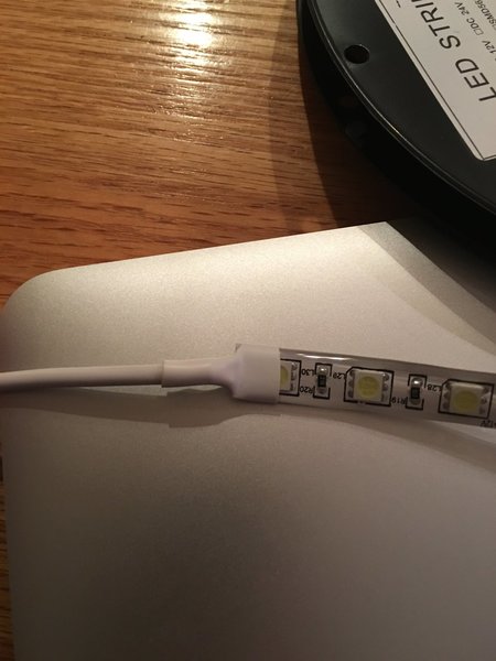

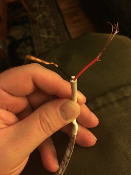

    Hey everyone, I have been looking for this type of wire everywhere I think the biggest problem is I don't know what to call it. Two independent wires within a single wire. Please ignore the wire ends its a piece of scrap LED. I found some speaker wire at Bestbuy that is sort of like this but it's got a soft ouster covering this outer insulating layer is solid all the way to the main bundle of wire.

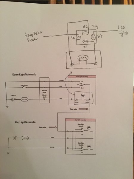

    If what I'm doing matters for your opinion this is for wiring up some LED's to the dome light for footwell and rear using the dome door/on/off signal for a relay switch.

    Looks sorta like 18/2 thermostat wire

    Have you tried Home Depot or Lowes? If bigbarlo is right about the 18 gauge then it would be called a 18/2 fully insulated wire.

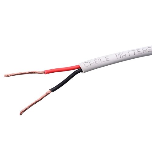

    http://www.cablematters.com/pc-463-...-cm-16-awg-speaker-cable-100-bare-copper.aspx that should do the trick but I just wanted the wire to be more insulated and look more like the picture. I'm not sure that it's really going to matter in the long run it's solely for aesthetic purposes and my own OCD.

    I'm glad to hear you used connectors Mike!!! I was planning on doing the same thing was going to go with Banana connectors incase the LED strip decided to die or I had a problem and needed to replace it I didn't want to have to rewire. I'll be putting the wires up thru the A pillars and up into the headliner to get it across instead of going underneath the carpet. I'll come up from under the seats and the little kick plate to get the wires to the back.
    I'll be using both the single strand double conductor wires but then will also connect using single strand as well with the banana connectors unless you tell me to use something different as a quick connector.

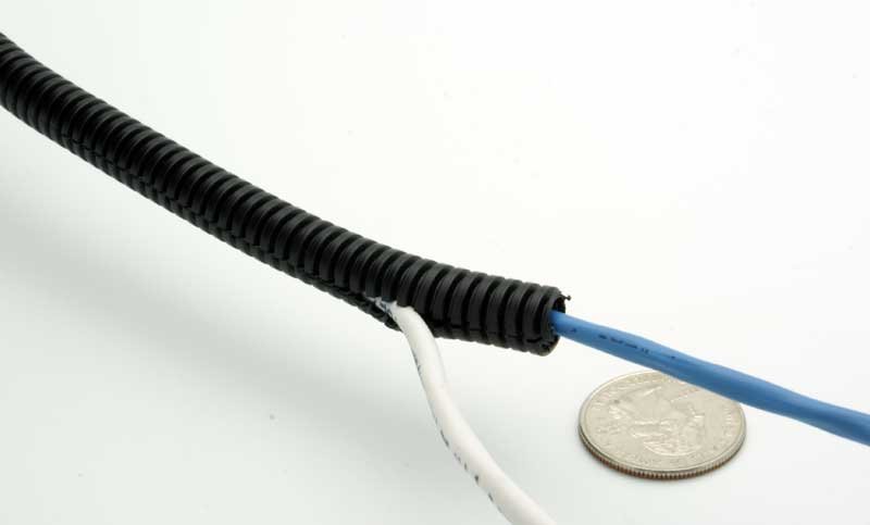

    I'd have to agree with that. Regardless of the cable you end up using I would run it in some "split loom" wherever it is exposed to make it look more factory.
