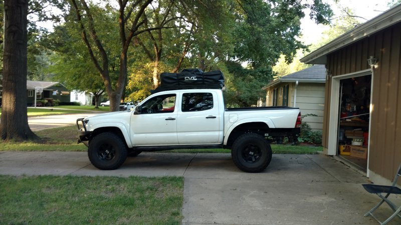

    other than clearance in trees there really isnt a downside to mounting it there. 2nd gen but i had a hard shell RTT mounted for almost 2 years. my only complaint was the location of the ladder blocked whichever rear door on the truck from opening so i had to keep moving the ladder around to get in/out of the truck. i have also had a soft shell up there and still didnt have any complaints, other than having to climb around on the sliders to open/shut it (more work tucking fabric and zipping shut). the soft shell didnt have the ladder issue blocking the door though since it gets spaced away from the truck when it unfolds.
    i had zero effects on gas mileage with either tent, but that might be because i already get terrible :notsure:

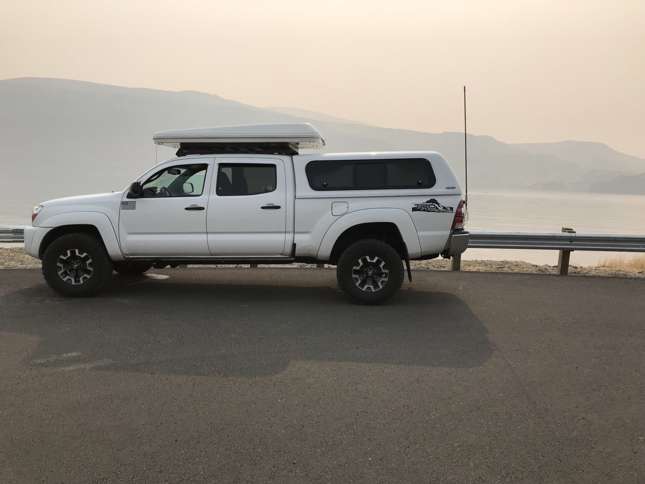

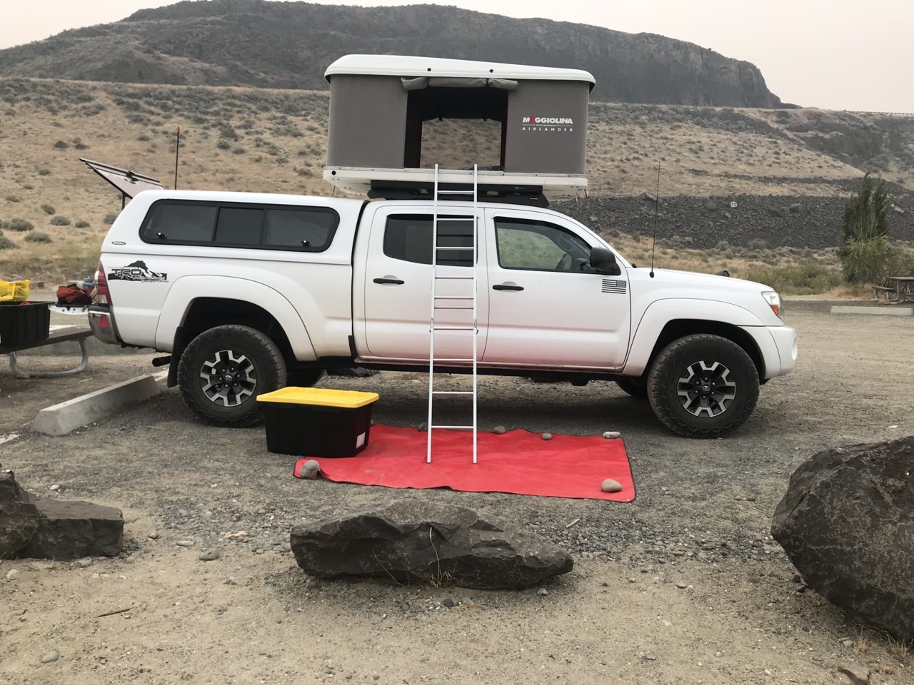

    Did your hard shell have a high pitch whistle? I had mine in the exact same spot and the whistle was god awful and loud as hell.

    Here is my old setup. Haven’t made one for new truck yet.705FC235-8C1B-4BCA-8922-CA8BAFDF033F.jpgCF0E2AC4-BA08-42D8-962F-D52C081E916A.jpg

    i didnt notice one. i had the seal for under the wind deflector on mine as well in case you dont.

    Current - 2019 DCSB QuickSand Previous -2011 DCLB White
    Mine was on a front runner, and mine did have a wind deflector. Oh trust me you would have noticed. I mean it was high pitch and pretty much meant you couldn't have the windows cracked at all because it amplified the sound and let it in.
