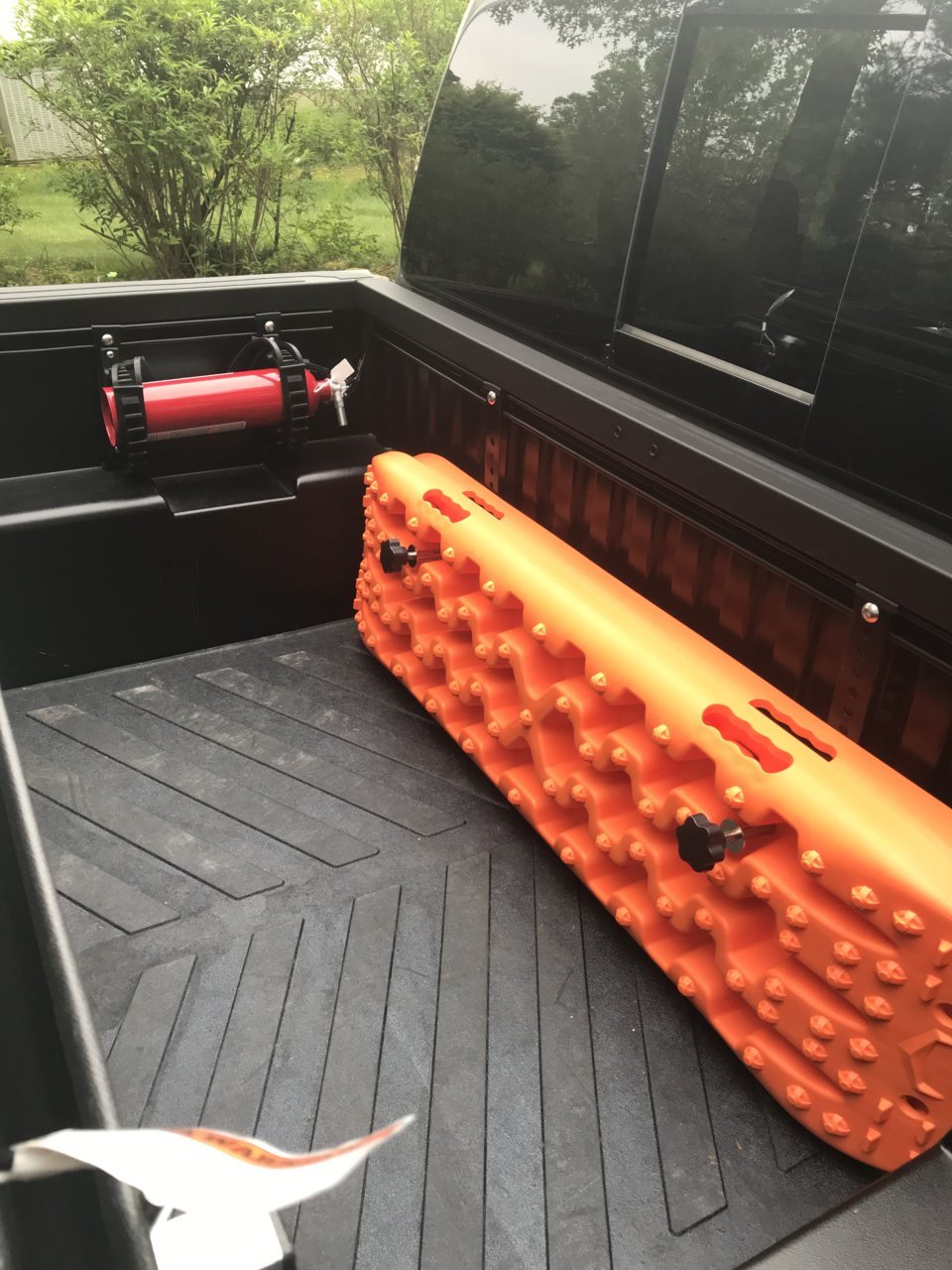

    I made a mount and put it in the bed close to the cab on the driver side… gets me out of the vehicle first in case something is wrong (i.e. burning).

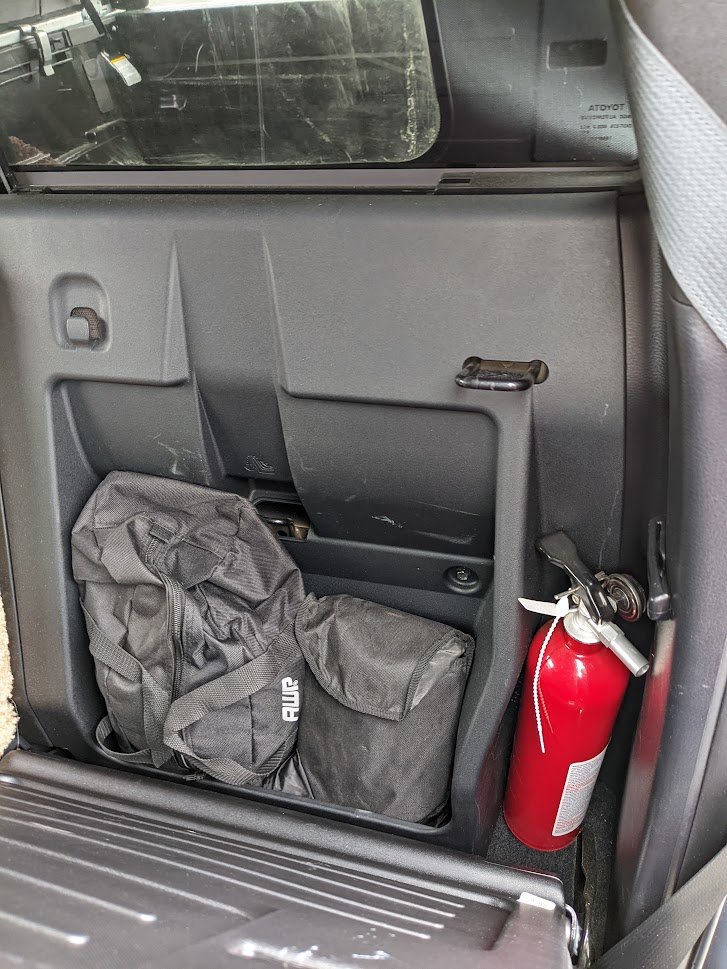

    +1 for the double cab cargo cubby behind the rear seats. Not as cool as mounting somewhere in the cab but it fits perfectly in the little side spot.

    Yep, almost like it was designed to hold one. As soon as I saw that cubby, I thought "I know what's going there"!

    That is a great place for a fire extinguisher. Hidden behind the back seat. Toyota did a great design for storage space behind the back seat and under the seat. Thumbs up here!

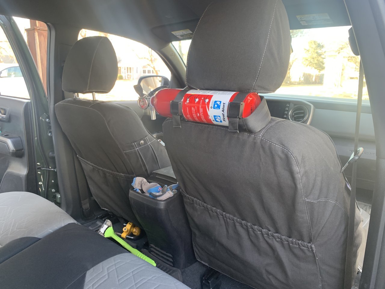

    This is where I installed mine. Fits perfectly and clears the door when closed.
    My thought was that I want it to be accessible quickly but out of the way. The only issue I have is when moving the seat all the way back it scraps the trim on the bottom of the B-pillar.
