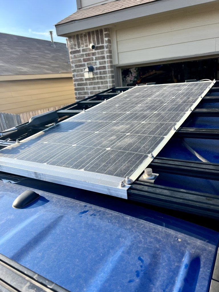

    • Solar panel (Renogy flexible 160W) will be mounted on top of the shell rack crossbars for now then in between the crossbars when/if I upgrade to a rigid panel down the road (flexible one was free)

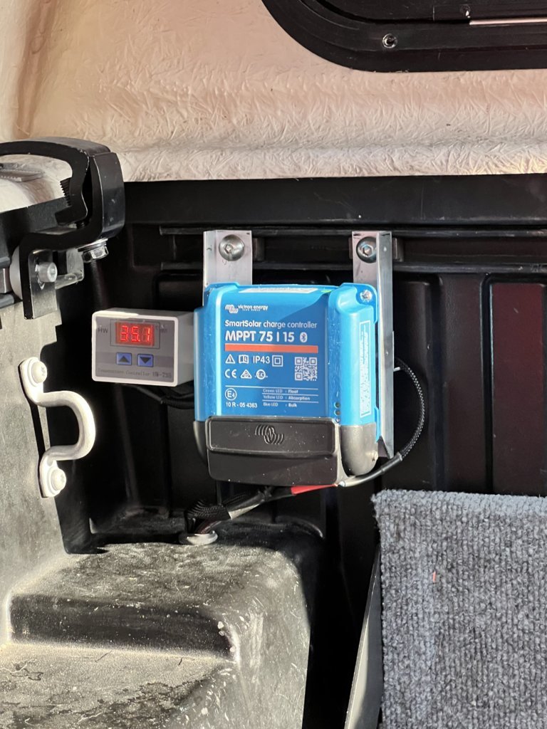

    Ended up mounting it in the bed, on the front rail. I have a topper, so it should be fine, though I will probably remove it whenever I use the truck without the topper. Got the battery sensory so distance between the controller and battery shouldn’t matter.
