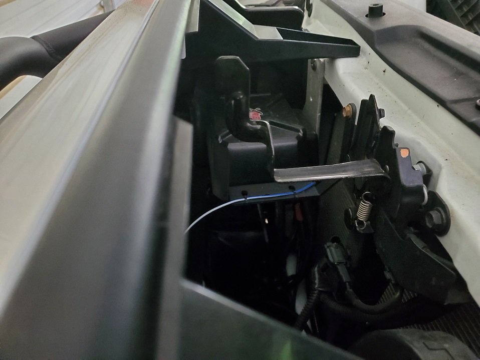

  5. May 3, 2021 at 5:52 AM
    Key-Rei
    Key-Rei Well-Known Member
    Jun 20, 2017
    #221942
    7,863
    Key
    Florida
    2010 TRD Off-Road 6Spd 4x4 209BSM
    Locker anytime Fog Lights anytime Full LED light conversion TRD cat back Rear cat delete Exaust Y reroute away from actuator Alloy Clutch master 2000 4Runner "Dog Leg" shift leaver Marlin shift seats and bushing Rear seat delete Rear diff breather extension Chrome grille swap Debadge Rear seat delete Honda blower motor beefy plug and wire mod Anytime 12v and USB with volt gauge in bed Blue Sea fuse box Hella AND 70's Caddy horns Low profile recessed hex drain plug swaps Alluminum battery strap 7pin relocated Backup cam on anytime Various other creature comfort and personal taste mods.
    @Foster Imposter :D
    You got any pictures of where we ended up putting yours? Unfortunately I didn't save any.
    As for OP what we did is while we had the grill out to install the CBI bumper drilled into the lower and upper core support installed some nutserts and custom fabricated some brackets out of aluminum and stainless that I had.
    If you're willing to extend the wires which can be expensive based off the cost of copper alone given the gauge you would need probably 2/0 you can put it nearly anywhere, a good place would be in the engine bay either behind the headlights if you've got space or up towards the fire wall behind the air filter box.
    It's good looking bumper because of how snugly it fits and contours the front end and clears everything but the downside of that is there really is no space inside of it.

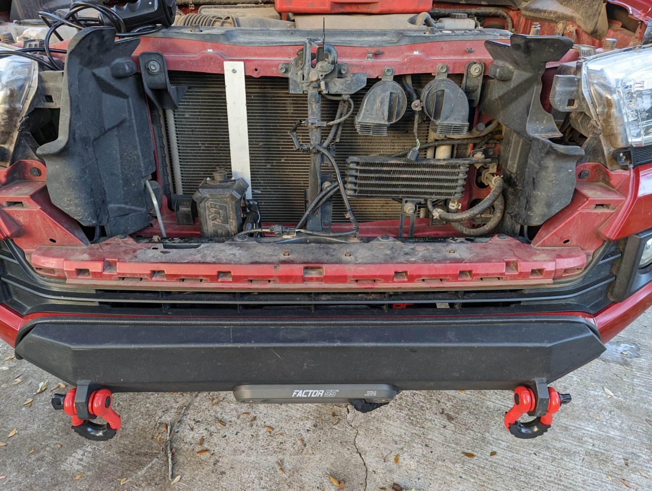

  7. May 3, 2021 at 7:56 AM
    Foster Imposter
    Foster Imposter Well-Known Member
    May 16, 2019
    #293475
    532
    Art
    Out in the woods, GA
    2018 PRO MT
    This is the best picture I could get without taking off the grill.
    (Almost the same location as @EatSleepTacos).
    I'll add that this seemingly made no difference in coolant temps even though it does partially block the radiator.

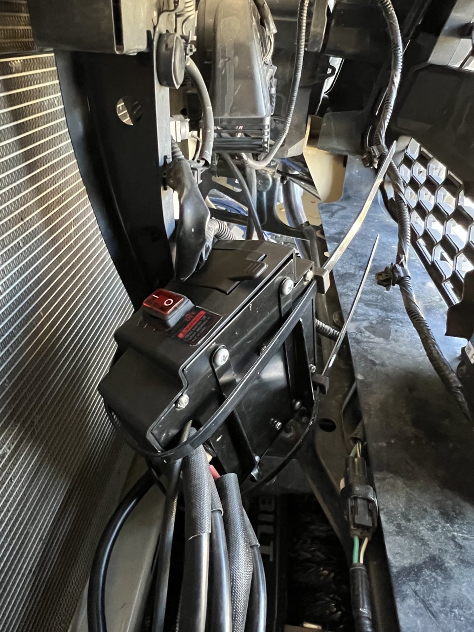

  9. Nov 8, 2021 at 12:36 PM
    miamijime
    miamijime Well-Known Member
    Jul 4, 2018
    #258334
    263
    Jim
    St Louis MO
    2018 TRD Off Road Quicksand MT. 1980 HiLux 4WD long bed
    SwitchPro, 2” lift, TRD rock rim wheels, Japanese numbers + character on shift knob
    My Smitty controller is currently zip tied to the center support, looks 2A556979-F7CE-4C0B-825B-1D809EFA31DD.jpg BC829C1D-87A0-4D43-9512-C4D3895C7C64.jpg 3949943C-ECDB-469D-B737-B77387D25726.jpg pretty Hoosier but didn’t come loose on 2000 mi road trip. Like to move it to the left side, several existing holes, it’ll take a new harness, kinda bugs me to block radiator. Used the passenger side space to mount ARB twin and air tank.

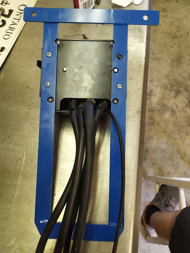

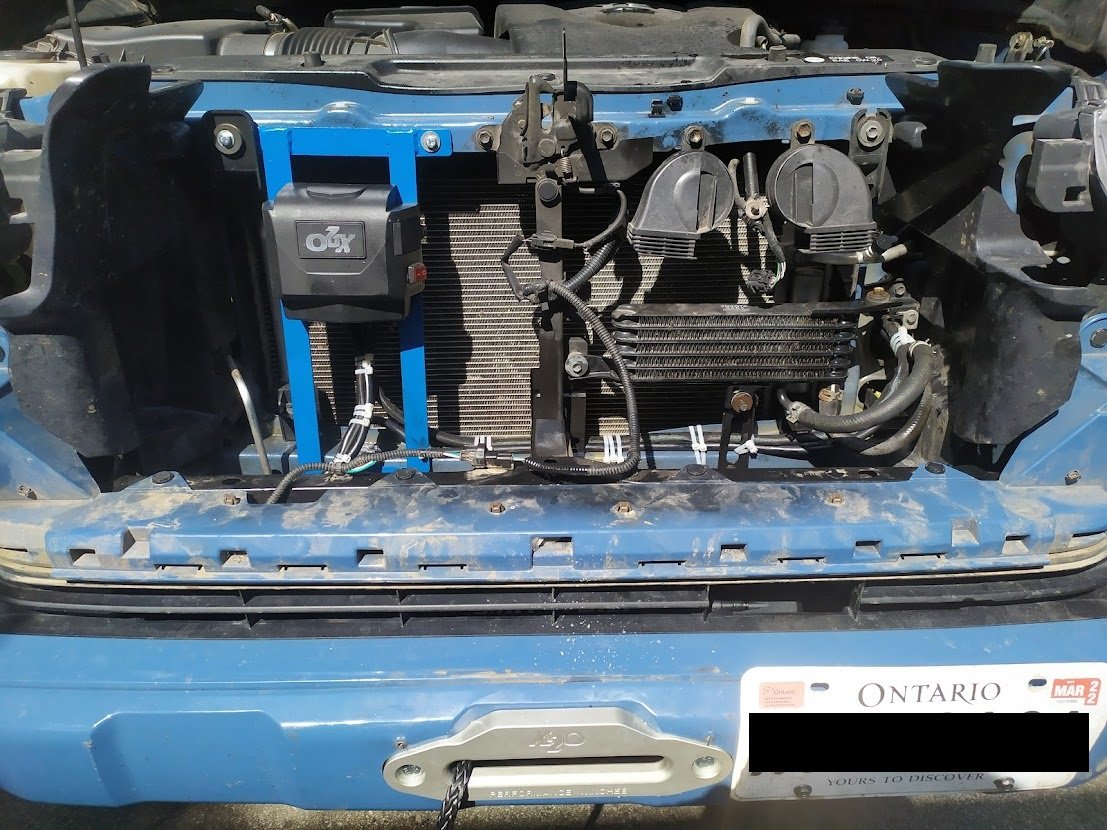

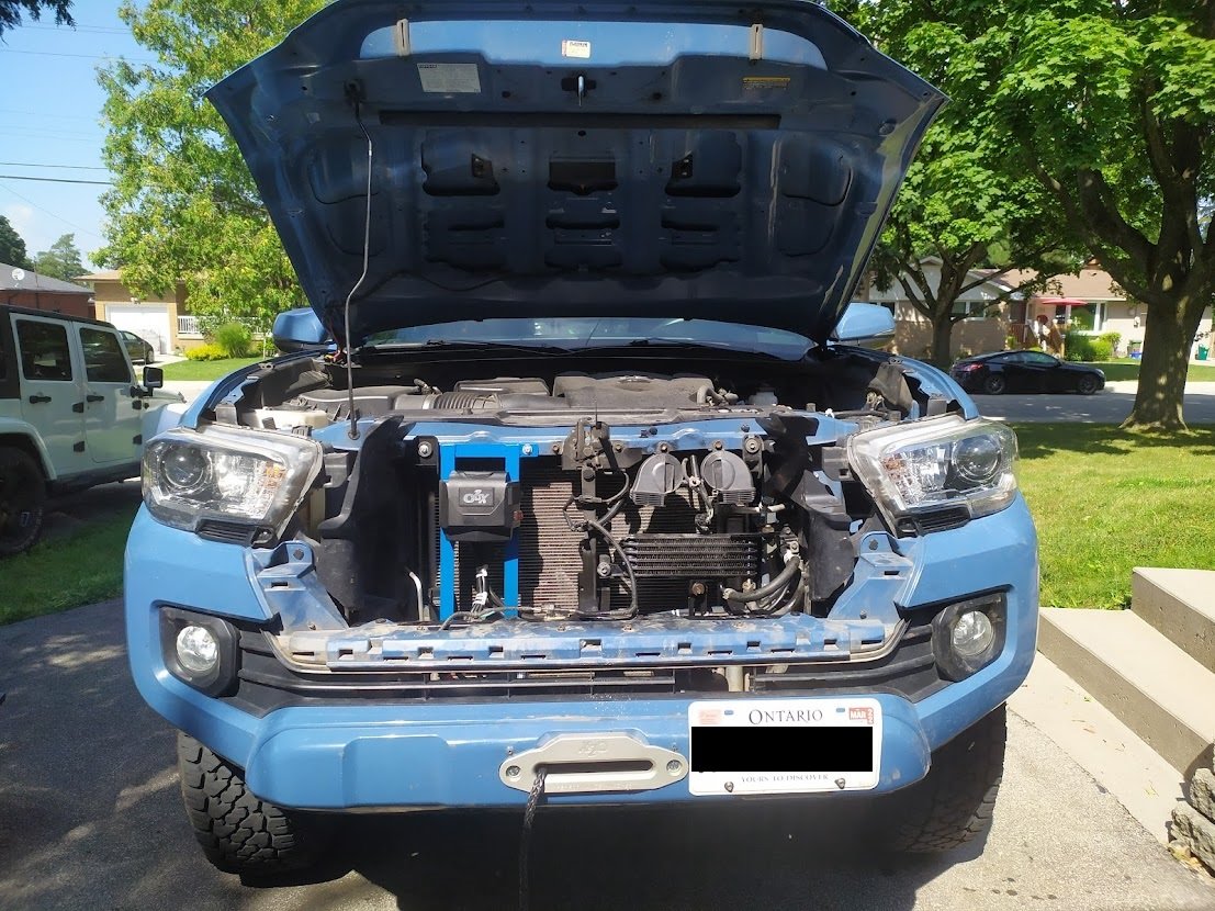

    somebody
    somebody GAR-FAB.ca
    Feb 11, 2019
    #282699
    1,134
    Jason
    Durham ON
    19 DCLB Sport
    This is what I did. Uses factory threaded holes on top and a nut and bolt on one of the existing holes at the bottom. Required no modification to the provided smittibilt cables.
    mbErktySyVtoJehP6yBZ1KWNIoBryFQ5zwAYWZci_255f58192de434ad05de7c41191fb44c7f29e405.jpg

  13. Nov 8, 2021 at 2:17 PM
    somebody
    somebody GAR-FAB.ca
    Feb 11, 2019
    #282699
    1,134
    Jason
    Durham ON
    19 DCLB Sport
    Its just a few pieces of 1" x 1/8" flat bar that I cut and welded up. If you don't have a welder the whole thing could easily be bolted with some flat head screws to join the 4 corners of the 1" bar.
