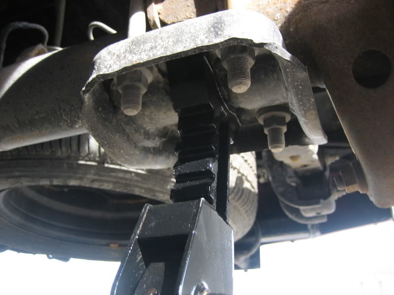

    I needed to jack up the truck to rotate my tires. I needed to lift the suspension off the ground so lifting with the frame was out (would only flex the suspension).
    Ideally, I wanted to lift all 4 tires off the ground but only have 2 stands and 1 jack. I suppose it's not safe to remove 4 tires when it's sitting on a tripod like that. Anyway, where should I place the stands and the jack?
    I tried reading the book but it's not exactly clear. Here is where I put everything (right or wrong):
    To lift front passenger:
    To lift front driver:
    *ignore the jack stand - it's only there as a safety precaution if the jack fell

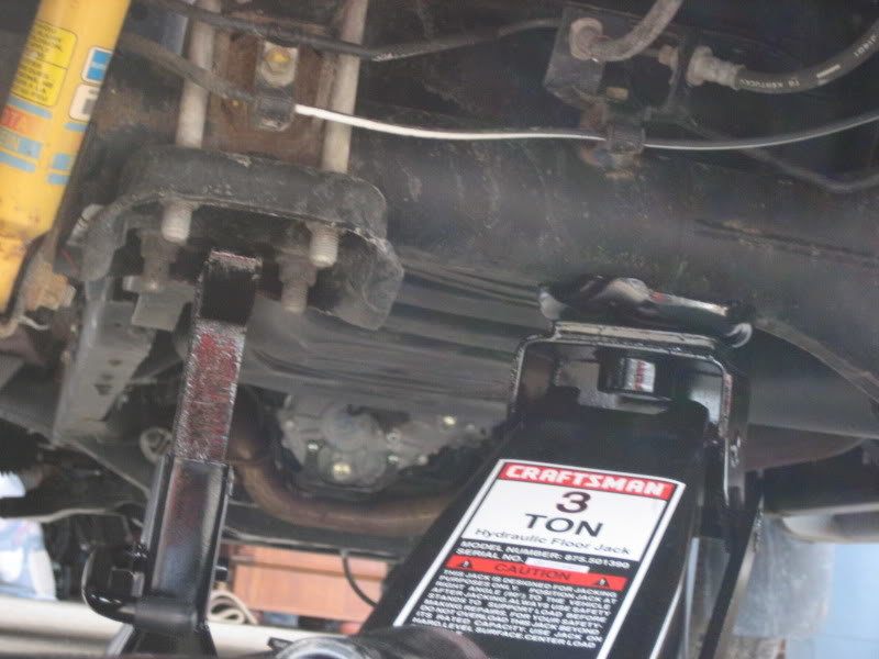

    Placement of jack to lift rear driver:
    Another angle
    Jack stand under rear drivers:
    How is all of my placement?

    I never lift the front like that. The control arms are just to unpredictable with the metal to metal and angles. I always use a 12" long 4x4 piece of wood on the jack and then lift from the crossmember. Then place jack stands under the frame rails right in front of the body mounts where the frame rail is boxed and wide right there.

    Did you look in the owners manual? There should be diagrams in there to show you where to jack from.
    Never jack up on the axle tubes, you could 'bend' the tube. Jack from underneath the differential housing at its lowest point.
    You don't want to jack from underneath the a-arm either. You're putting all the weight up againest the joint/bearing/bushing.

    I always jack the rear up first with the jack placed right in the center of the diff. Then place jackstands on either side in the same place you did right where the leaf springs attach. For the front, I place the jack in the middle of the crossmember/subframe, jack it up there, and put the jackstands on either side of it, and leave the jack with a little tension on it distributing the weight across the jackstands and the jack.

    Keep blocks of wood around to make up for the short jack. Just make absolutely sure everything is lined up and that the weight of the truck is directly over the jack.
    Also, full droop shouldn't hurt any of the components, especially when the truck is not in motion.

    The jack location in the first pic under the control arm is essentially letting the suspension flex as you jack it up. Exactly what you said you didn't want to do. This is also a little more hairy seeing as the point where you are jacking from will be moving around as you go up...

    That's a horrible place for the front jack stands. I once started to jack my truck up with the bottle jack under the control arm in the same spot. Jack was going up but truck wasn't. I was just bending the metal in the control arm, it's very soft right there.

    Thats good to know because I always jacked my truck up from the same location as the o.p. (well even towards the front tires more), not right under bushing) at least twice a year to change summer and winter tires. Learn something new everyday :)

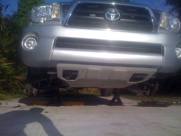

    I jack by the frame close to the body mounts. I have hilift jackstands that allow me to go full suspension droop and still have the tires off the ground. I use wood under my bottle jack to give me the lift I need and unscrew the top to raise it.
