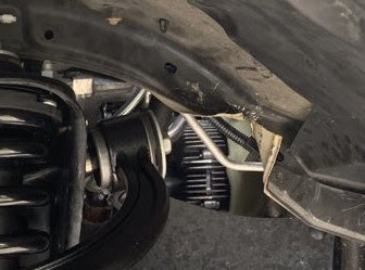

    Dealer parts counter or Wheeler's Off Road have those. Depending on your truck's build tolerances, you may have to butcher the inner fender aggressively to get the existing bolt out. The cleaner solution is to cut the bolt head in-situ with a cutoff wheel and install the replacement bolt from the rear.

    The long bolt is $20 apiece, so $40 + shipping for two:
