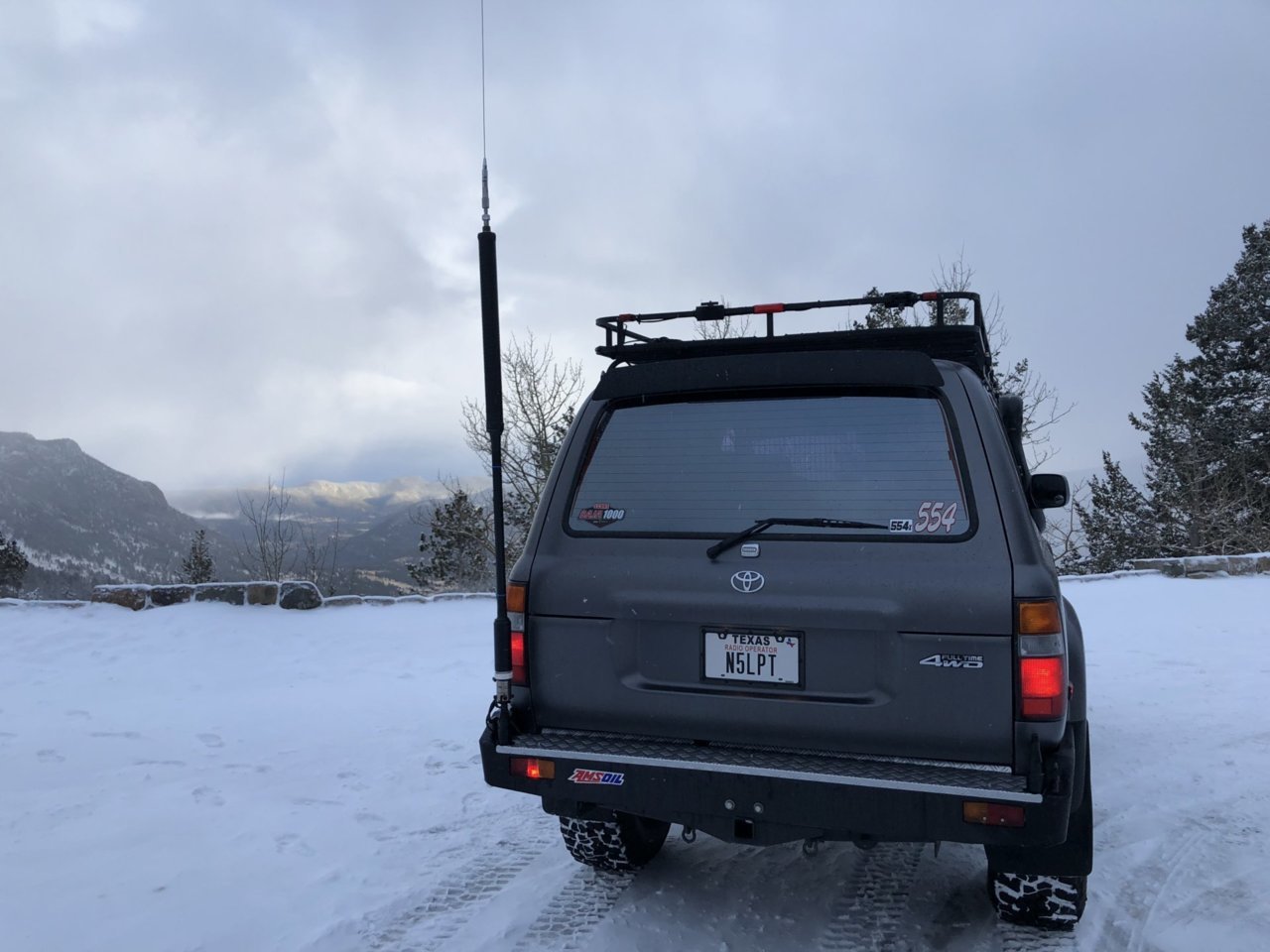

    Put a high clearance bumper on the back with a swingout put the antenna on the bumper. That is where we put my brothers and will be doing the same to mine.

    Not of his but this us one we got the idea from. It's a radio friend of his

    That's an HF rig, but that's nice. I'm getting the roof rack installed and I realized after I negotiated for it that it's really just roof rails and not a rack at all. Anyway, I want a serious roof rack and I'm not sure where to get one. But I'll probably wind up mounting it to that along with some LEDs and a hi-lift. How did they get the antenna wire out of the cab?

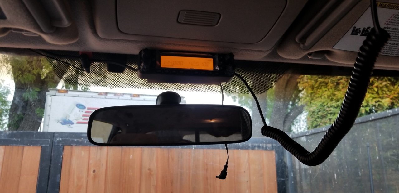

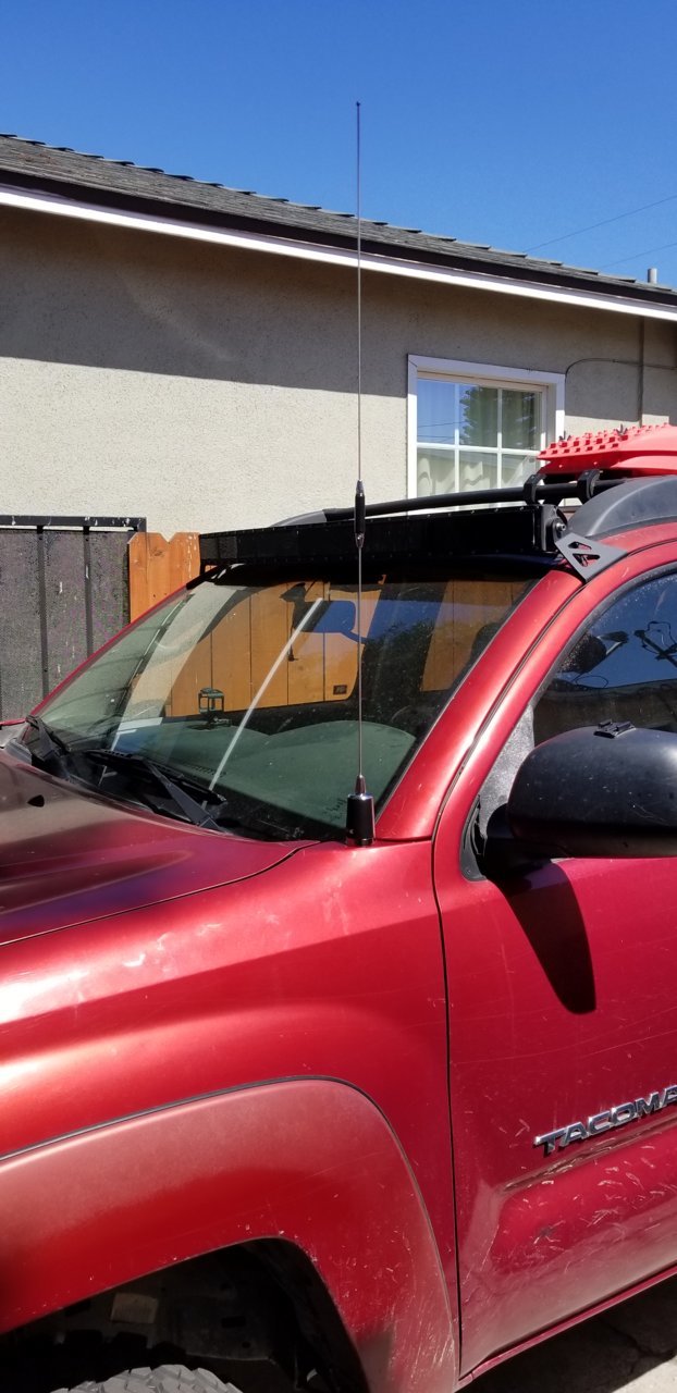

    how i mounted mine using gopro mounts for the face plate
