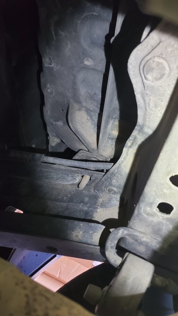

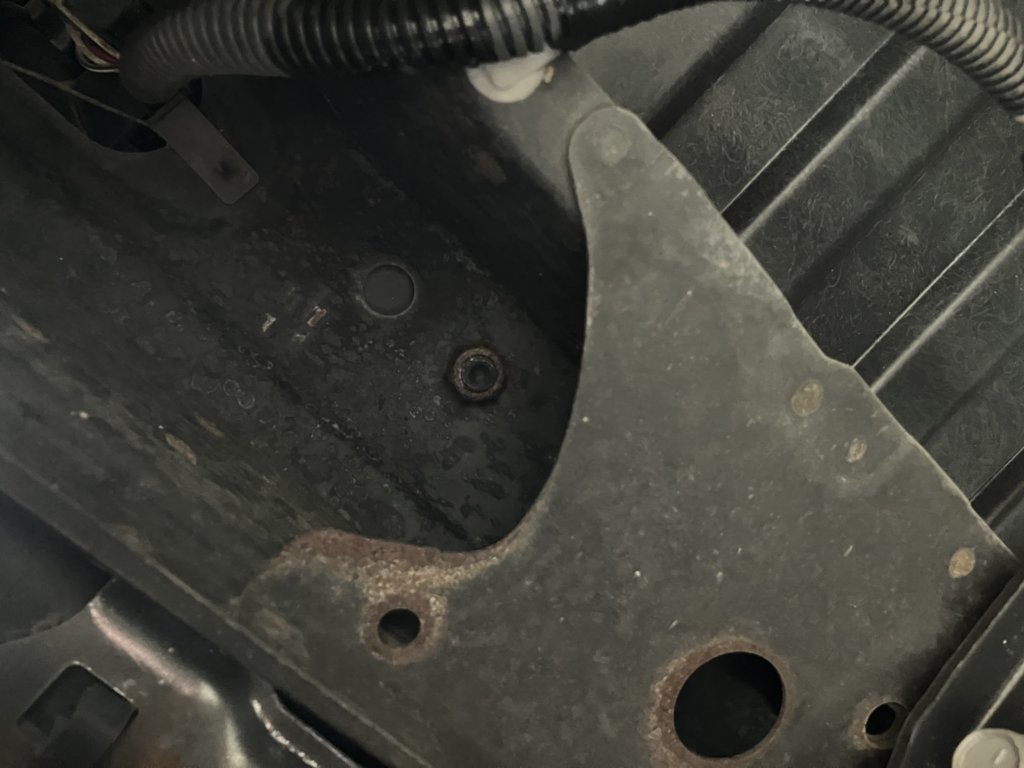

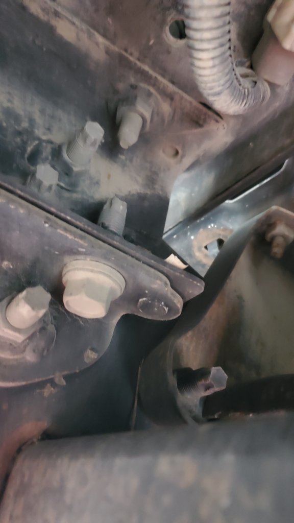

    If you look inside the frame channels from underneath you can see where they come through.
    17316207577598721630881306049108.jpg 17316208062738913294205719800667.jpg 17316208637813513470205183404247.jpg

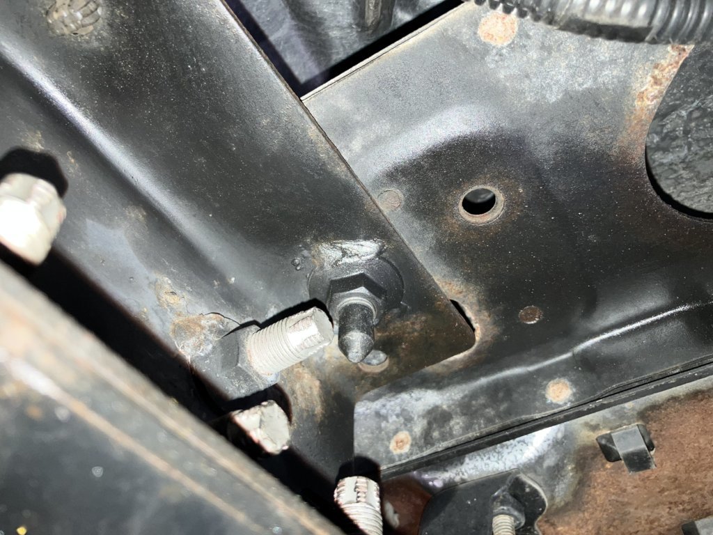

    The little swivel bolt isn’t easy to spray.
    You’ll need a good creeping oil to soak in and UP the threads.
    The big bolt is easier.
    It will be messy, but you can get to more of it.
    Swivel mount bolt. It is right at the corner of the bumper. Where the wire harness goes up into the bed.
    The big goes down in to the frame
    IMG_4663.jpg .

    Those are great pics, super helpful thanks to the both of you!!! Makes me want to be under my truck right now lol. I need to put some old clothes on and crawl under there with the PBblaster can! hopefully it wicks well.
