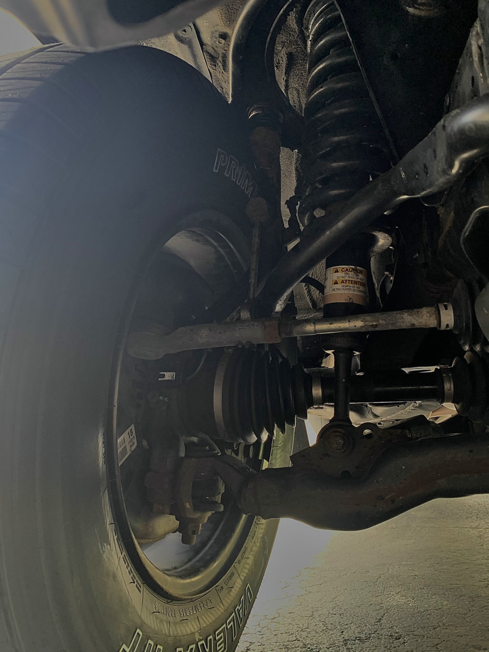

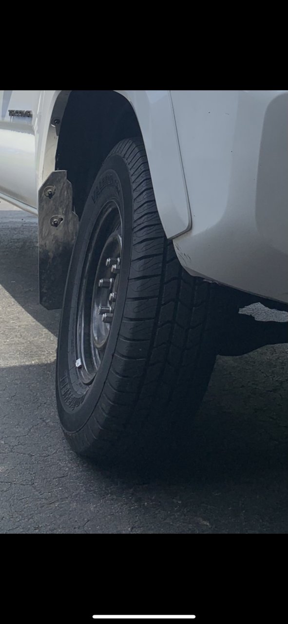

    This is a bad picture, however I will get better ones for you guys tomorrow. The question is, from what you guys can see, what is causing this crazy camber? The taco hit a curb at higher speeds and the suspension is not seeming to match up. It seems the upper ball joint is out of place, so would replacing the upper control arm be beneficial to bringing back the life of an alignment? Could the steering knuckle be bent? What would be the first part you would replace? What would be your first move to bring the alignment of this taco back to life? I also do understand taking it to an actual certified mechanic is an option. However, I am asking behalf of tackling this job individually. The Tacoma can not move due to the tire rubbing on the upper ball joint area at the top of the steering knuckle. Any amounts of information would be appreciated.

    Knuckle (aka "spindle") looks to be bent. Known weak point with our trucks when going off road with oversized tires, let alone hitting a curb at speed.
    Rock Auto sells the knuckles at reasonable prices. There's a CV axle seal on the inside of the knuckle that needs to be bought separately. Also get new cotter pins for the upper ball joint, tie rod, and axle nut.

    Youve also got a decent amount of toe out. Pull the tie rod and roll it around to see if its bent also.
    Jack up that front tire and see if it will spin by hand when its drooping. If there was enough side load at impact it could have jacked up the knuckle inside the CV axle boot. If ifs messed up, it will sound/feel like a bag of marbles inside the boot

    You mean YOU hit a curb..... new suspension

    Make sure the wheel isnt bent and watch out for issues with the steering rack. All that force has to go someplace. look at the upper and lower a-arm mounting bolts and see if something shifted there. I would pull both wheels and run a strait edge from the rotors up and measure the knuckle at several points comparing to the other side. If bent replace it why do the job twice. As for straighten it once you bend metal is is far easier to bend it again I wouldn't count that as an option with the steering knuckle. Once done you gotta go to the professional to get it aligned anyway.

    Bent spindle. Bent UCA. Can't straighten either component. Good luck.

    *Edit: I agree that the steering knuckle (which the whole suspension connects to) is probably bent to shit. Take some time to lay under the truck and inspect all the components. Post better pictures and we will be able to advise you better on what is bent.

    If the damage is limited to replaceable components like spindle, UCA, steering rods, etc Id aggrege. If the damage extends further into areas like the coil bucket / UCA mounting points, then that may be a significantly larger issue.
    For what its worth you'll be able to pick up a set of OEM UCAs on here for cheap. Guys replace them with aftermarket all the time and sell for cheap
